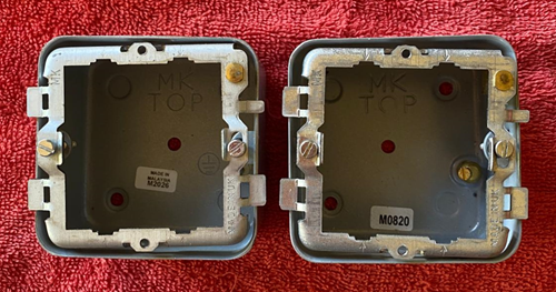

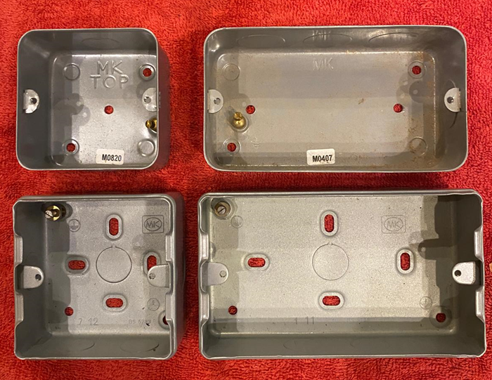

I find that I partially lied. Although I have some on my shelf, I have very rarely used surface grid boxes, and the one I recently used (which reminded me of this issue) was certainly a 'flush' one. Having now looked more carefully, the surface ones (lower pair in pic below) are, indeed, as per the pics in your link - with one central knockout in the rear and fixing 'slots' (rather than circular 'holes')
However, in the case of the 'flush' ones (upper pair in pic below), there are definitely no rear knockouts in mine, and there are circular fixing holes (rather than slots). So, either things have changed (it may be quite some time since I bought these) or the ones I have (marked "MK") are (imperfect!) 'fakes')!
The upper boxes are mk but actually surface boxes there mk grid old style, now obsolete.
Standard deep knockout boxes were used then and even now for flush if needed.
There metal cover plate was much slimmer then.
Back in the day they were commonly used with surface steel conduit, hence likely limited need for rear knockouts.
The lower boxes are surface boxes too, but are mk grid plus which is still current.
The one knockout now possibly for option to have back to back switches in two rooms

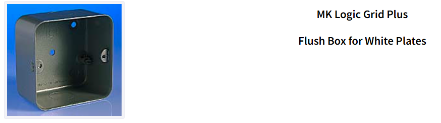

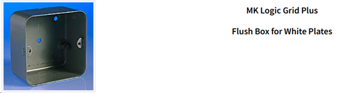

I'm getting pretty confused! TLC are currently still selling them as flush boxes for Grid Plus ...

This is getting very confusing! TLC are currently selling both flush and surface ones which look identical to the ones I have, as per photos in my recent post ...

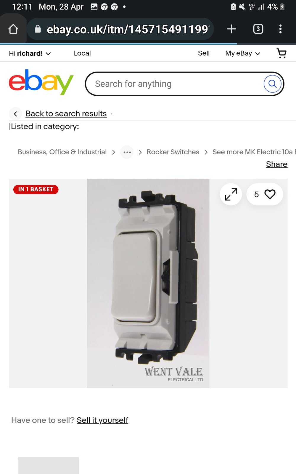

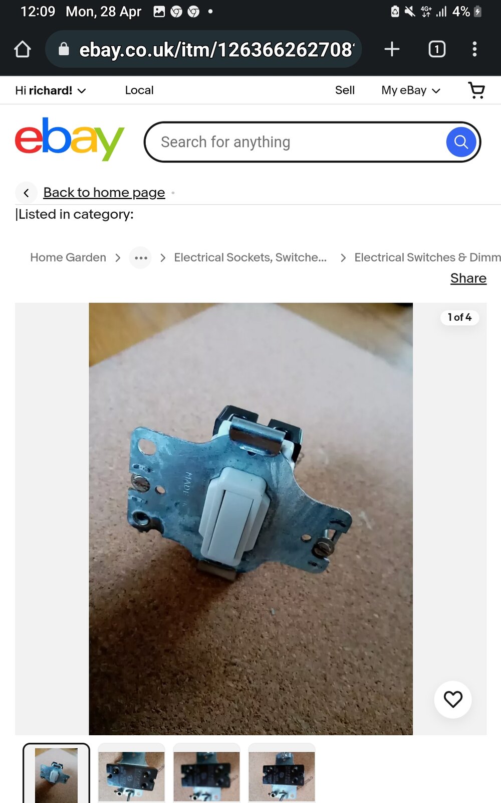

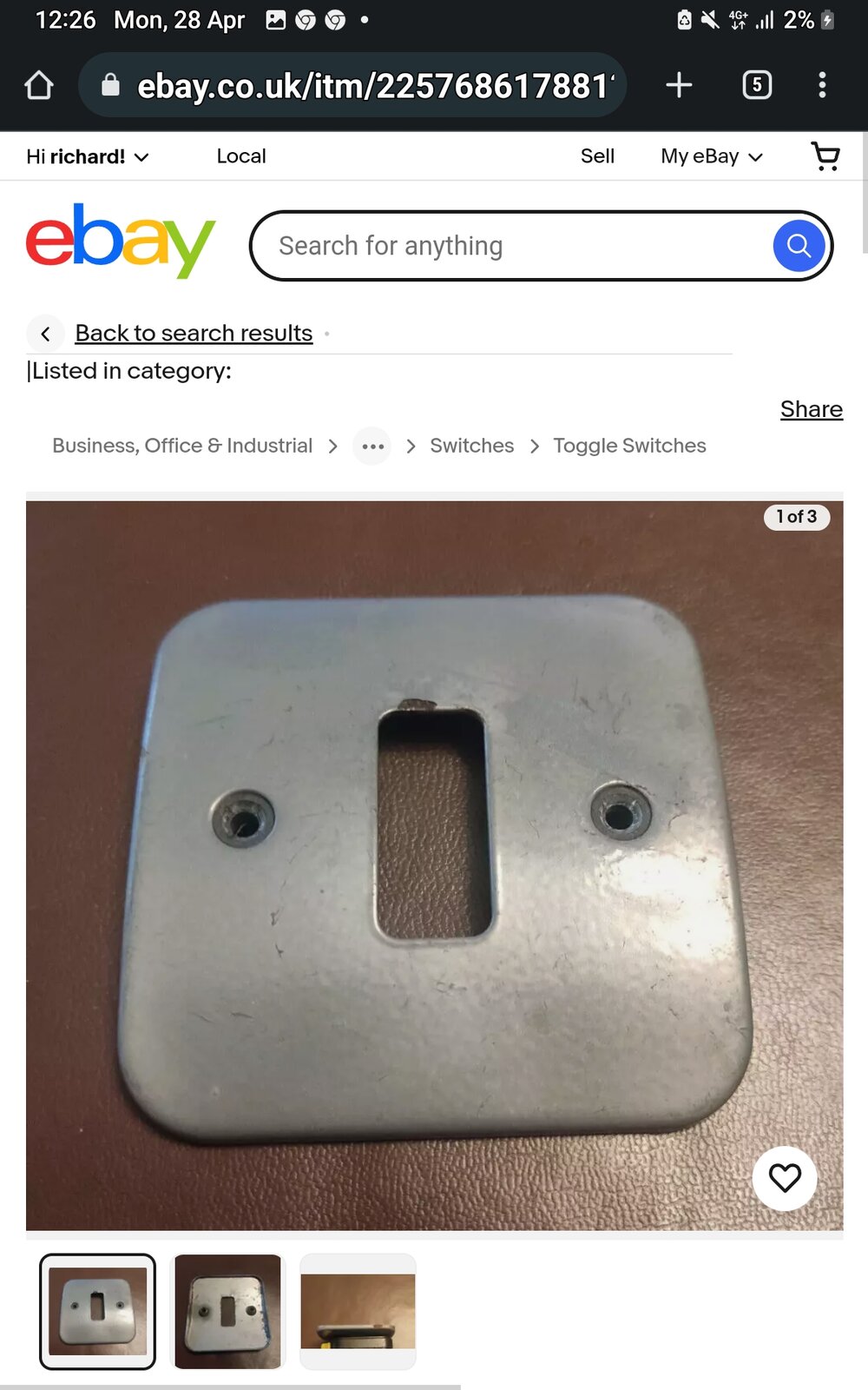

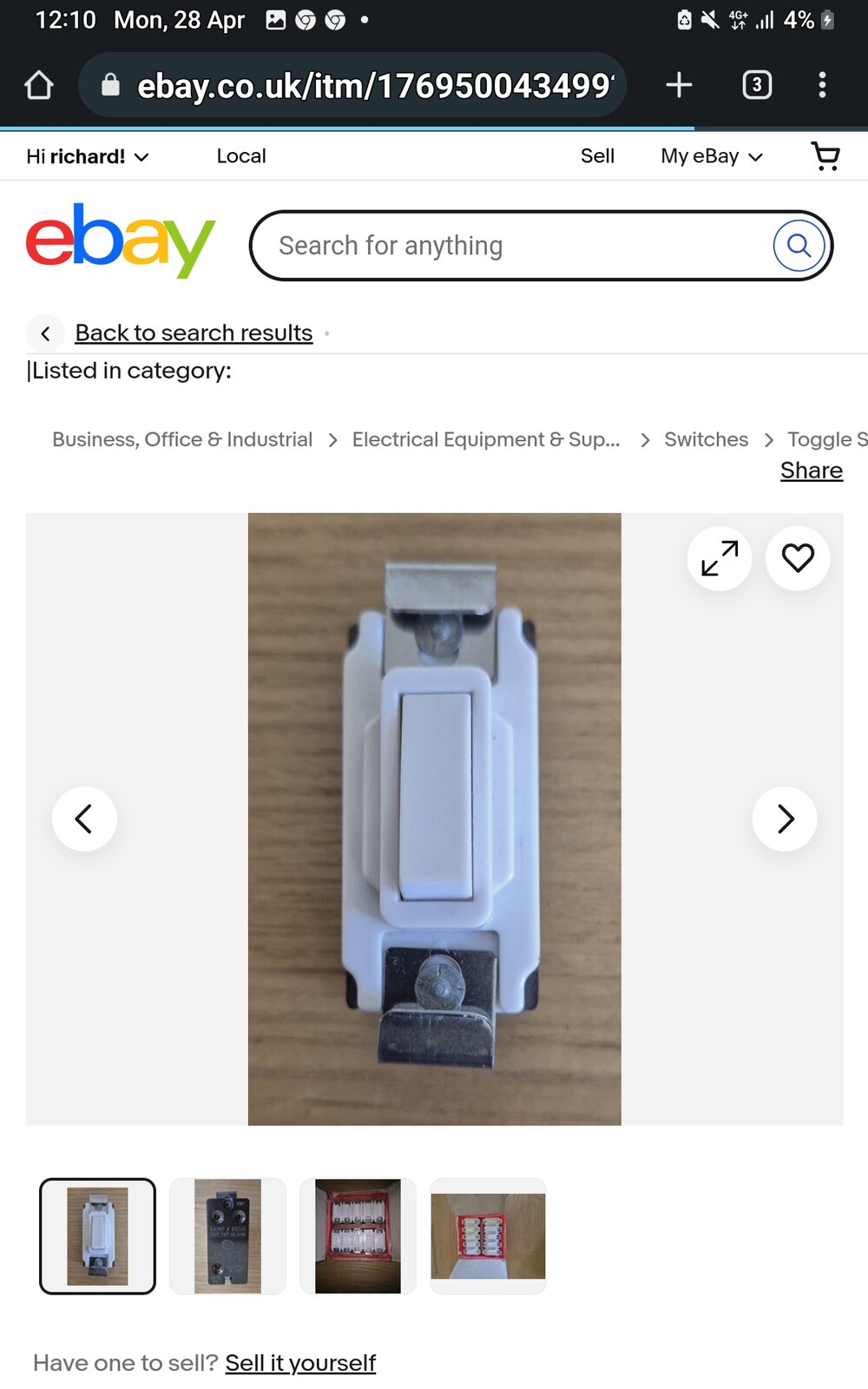

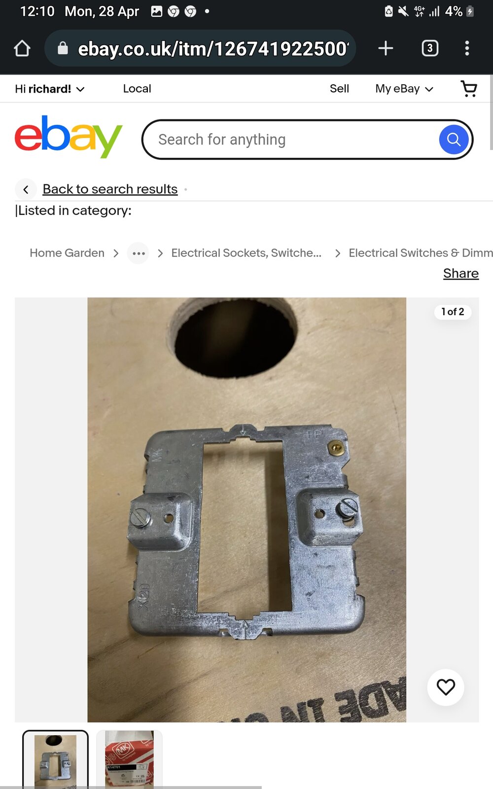

The new grid plus frames are much chunkier, my mistake I forget both frame types have adjustment, so the back box adjustment like on the Appleby flush box is less critical.
As you can see by the chunkyness of the new grid plus frame, I feel you would not get much adjustment up/ down with that inside the so called flush box, whereas the older frame would have.
Though as you say, many on line are saying that mk 891 box is flush and grid plus, the newer range.
However most mk parts now, including gridplus, have the prefix "K" before the part number, which suggests this part number existed prior to the Gridplus range even existing.

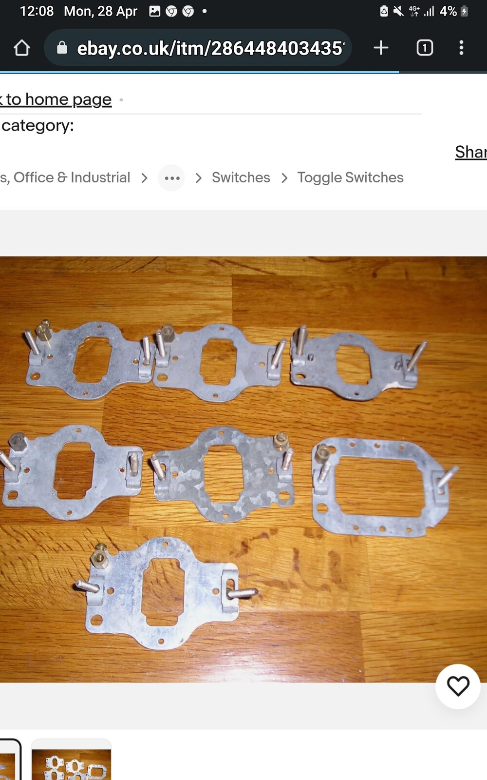

The original gridswitch had two locating dimples and fits from the rear of the frame and the metal tags push on too lock.
The newer grid plus clips into the frame from the front and much squarer looking more like a euro module
The aperture in the cover plate is also. wider on the new gridplus compared with the older Grid

The new grid plus frames are much chunkier, my mistake I forget both frame types have adjustment, so the back box adjustment like on the Appleby flush box is less critical. ... As you can see by the chunkyness of the new grid plus frame, I feel you would not get much adjustment up/ down with that inside the so called flush box, whereas the older frame would have.
The amount of adjustment is fairly limited (although I'm not convinced that it is a lot less than it would be with any frame/box). The photo below shows the limits of what is possible. The slots themselves would actually allow for a bit more adjustment, but it is prevented by the bent-over bits of the frame at top and bottom hitting the inside of the box.
The newer grid plus clips into the frame from the front and much squarer looking more like a euro module ... The aperture in the cover plate is also. wider on the new gridplus compared with the older Grid

Yes, it fits. However (now just having tried and confirmed) that frame does, indeed, also fit a standard metal back box - which leads me to wonder why anyone (including me) bought any of these (presumably more expensive) 'special' grid back boxes. Am I missing something?

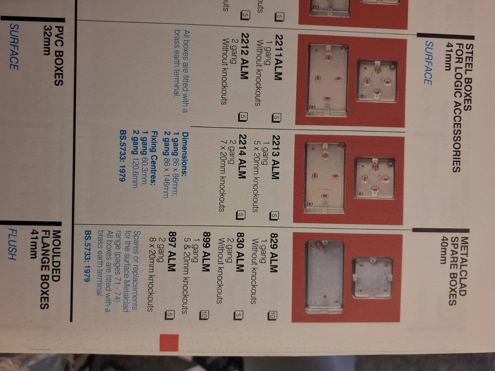

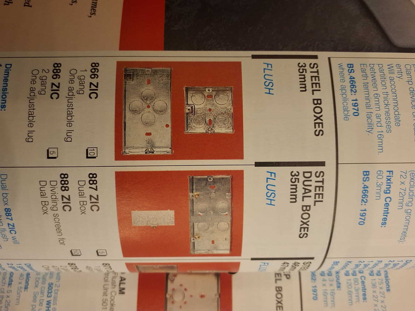

Been a while, turns out back in 1992 before gridplus the mk 891 was sold as flush or surface as you say,.
I had only ever used or seen them surface with metalclad fronts, these metalclad fronts at 76 x 76 fit snugly on that 73 x73 box, however not much tolerance when that box flushed in.
However they made other grid fronts like logic at 86 x 86 so would not be such an issue on a mk891 flushed in.
So i quess thats maybe why they were sold as flush/surface
They also made a similar bigger box mk829 aprox 81 x 81 as a spare, for surface mounting single metalclad sockets etc which were always supplied with a box included.
Also at that time they sold the traditional flush steel boxes at 75 x 75, which if used could have been more of an issue with the smaller metalclad 76 x 76 cover plate.
Only 1mm clearance as opposed to 3mm with the mk891 box flushed in.
Maybe another reason they suggested using that as a flush box
Anyway them small metalclad covers would look rubbish on a flush box so most opted for the bigger sleaker albany mco range covers which fitted perfect, even over a flushed in standard knock out box
