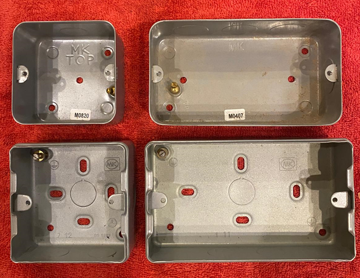

What boxes do you mean, im pretty sure they do have one knockout in the back centre and four fixing slots, the lack of knockouts i assume because they have prioritised the fixing slots.
To me the standard flush boxes with the four rear knockouts often hinder where you want the fixings to go
I have a fair selection on my shelves - MK grid boxes (surface and flush, single and double) and surface metalclad boxes (various makes and ages, both single and double) - and I can assure you that none of them have any knockouts on the back (although all have knockouts on all four sides. Some of the metalclad ones have one or two 'fixing slots', as well as round fixing holes, but the grid boxes only have round fixing holes.
I could take photos to prove the above statements (and will, if you really want me to!), but I would hope that you can trust me to be telling the truth!
That can very occasionally be an issue, but is usually fairly easily got around. Mind you, as I recently wrote, I doubt that any of us require rear cable entry all that often, so the absence of knockouts is not a major issue - more something I've just been curious about :-)
Hmm, when I look at the metalclad plus grid boxes, they do seem to have rear knockouts.
Interesting.
I find that I partially lied. Although I have some on my shelf, I have very rarely used surface grid boxes, and the one I recently used (which reminded me of this issue) was certainly a 'flush' one. Having now looked more carefully, the surface ones (lower pair in pic below) are, indeed, as per the pics in your link - with one central knockout in the rear and fixing 'slots' (rather than circular 'holes')
However, in the case of the 'flush' ones (upper pair in pic below), there are definitely no rear knockouts in mine, and there are circular fixing holes (rather than slots). So, either things have changed (it may be quite some time since I bought these) or the ones I have (marked "MK") are (imperfect!) 'fakes')!
