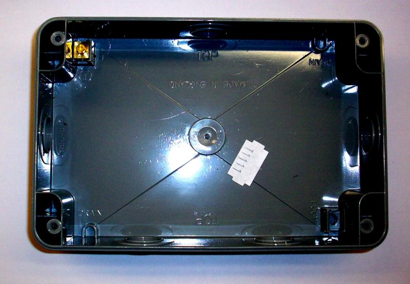

Having now found an old-style Masterseal socket to examine (and I suspect the same remains true of the new ones), not only can I confirm that they are 'invertable', but they also have those drain hole provisions both at 'top' and 'botton' - so there will still be one at the bottom even if it's inverted.
Interestingly, if ever one wanted a confirmation of 'invertability', it has 'TOP' written at both top and bottom !
(contrast exaggerated to show writing):
Kind Regards, John
