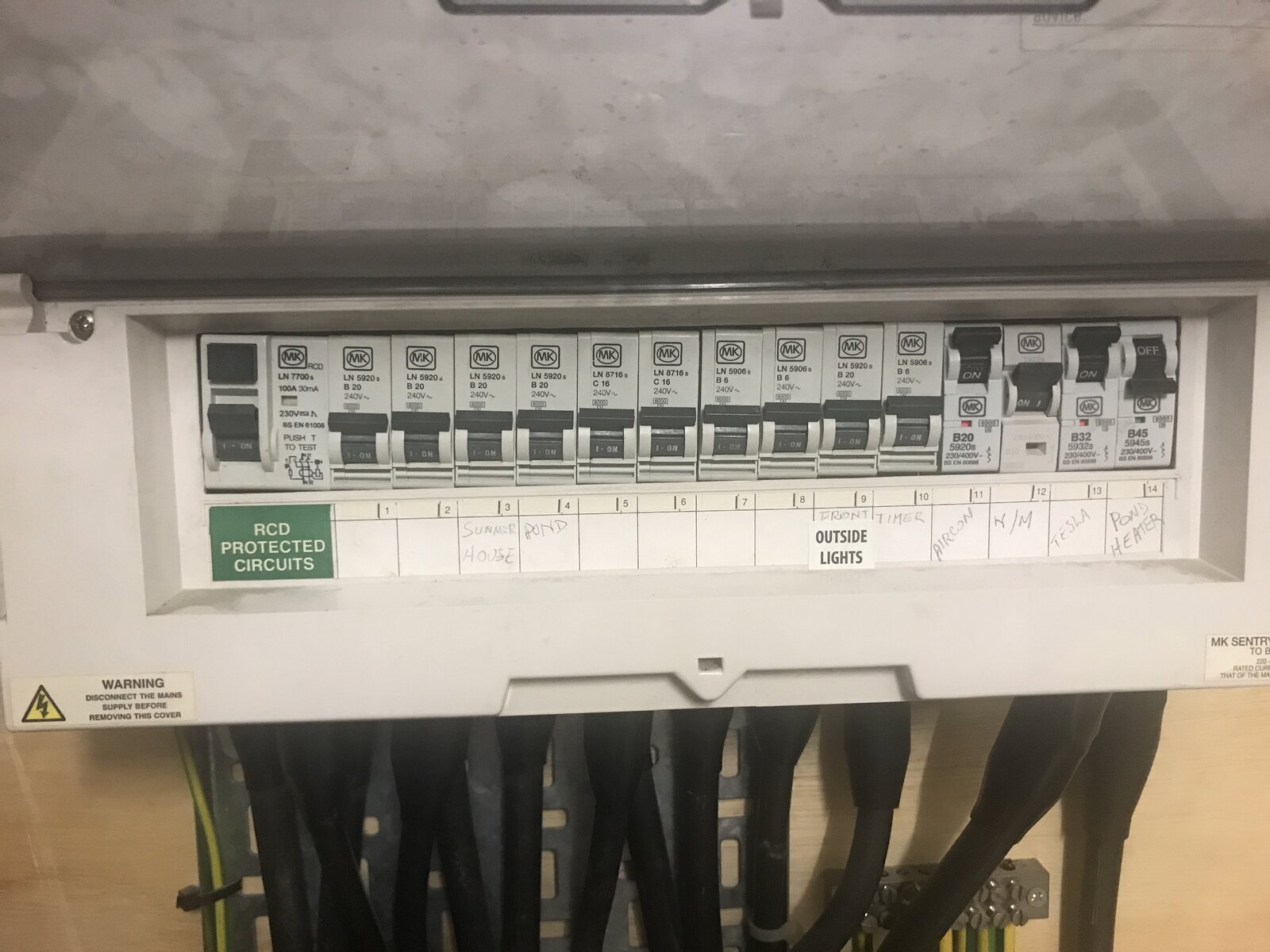

Hello, I suspect my existing RCB defective and would like to replace it, its a 100A LN7700
But I got the feeling its discontinued.
With what can I replace it, it,s on a 14 way CU
Thanks if you can advise
More likely a fault on an outgoing circuit, theres a good chance you will be wasting your time and money.
just going by the labelled circuits you appear to have a fair amount of circuits that are prone to Rcd tripping faults
I see an RCD. Is that the item that is tripping. ???
As above, it will almost certainly be one of the circuits causing this, not the RCD.
I smell problems when I see words like summer house, pond and pond heater (45amps, that’s a big heater!).
Get an electrician to test the connected circuits one at a time. That will probably identify the guilty party.
PS It is very bad practice to have one up front RCD. It is a single point of failure which is against guidelines.
It needs sorting out, but if you can afford a Tesla, you can afford a couple of hours of a competent electrician.
Looks like every circuit is SWA or am I mistaken? Lots of power consumed!
