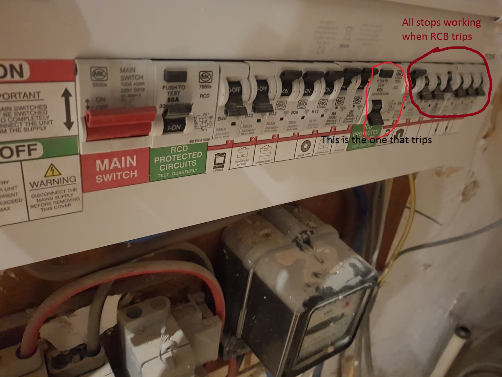

Hi All,
I hope I am using the right terms here, I have a situation where my consumer unit is 15 way, and I believe MCB are the breakers which trip when there is a fault with a specific circuit, and RCB is the main big one which controls either half of the CU or a group of MCB’s.
Now, if my assumption above is correct, what I am experiencing at the moment is situation whereby one of the RCB’s trip, but no specific MCB trips, so I don’t know what circuit is faulty and causing the RCB to trip. Whenever this happens, half of the house has no electricity and once I pull the RCB back up, everything works ag again, then randomly in the space of 1-2 weeks the same thing happens again, there is no definitive pattern, something just makes the RCB trip.
The RCB which trips is the one that is circled in the picture, and everything to the right of it stops working until I pull it back up again.
MCBs and RCDs detect different things. MCBs detect overcurrent. RCDs detect imbalance between the currents in the live and neutral conductors.
For whatever reason it has become accepted practice to have only a couple of RCDs for the whole installation. This is cheaper than using a RCBO (integrated MCB/RCD) for every circuit but it can turn into a nightmare when you have an intermittant fault.
Performing insulation resistance and earth leakage tests on all equipment in the house may find the problem, but then again it might not.
Moving circuits between the two RCDs may be an option, but it may be inconclusive especially if the actual problem is not one device but a small number of slightly leaky devices adding together.
Turning off a MCB may or may not stop the devices connected to it from tripping the RCD because MCBs only disconnect the live and RCDs can be tripped by a neutral to earth fault.
A final option is to rebuild (or replace) the CU to have a RCBO for each circuit from the problem group. If the problem was a bunch of small leakages adding together this may well fix it, if not it will at least narrow the problem down to one circuit.
What are the circuits that the RCD protects? It looks like one of those might be the garage? If so, I would start by looking carefully at things like outside electricity things like pond pumps, lights, etc that could be run from the garage itself.
Especially if the tripping co-incides with wet weather. It only takes a tiny bit of moisture to trip an RCD.
The long way is to by disconnect the garage circuit from the board (that means the live and the neutral)
The short way is to find an electrician with an insulation resistance tester.

Thanks everyone for those contribution, the circuits under the RCB are as follows.
Garage ( 4 x sockets and 3 x lights) and ip 66 outside socket.
Garden lights (3 x up and down light and 1 flood light)
Front door lights (2 x up down lights)
Drive over lights (5 x drive over lights and 2 x bulk head lights)
Kitchen sockets
Kitchen lights
1 free
I only have basic electrical knowledge and don't have any special tools. What I have done is isolated everything bar kitchen lights to see what's causing it. A friend did say it sounds like earth touching neutral somewhere.

I would suspect the garden lights or the drive-over lights. As i said, you would need to properly isolate each circuit*, one at a time and see if the tripping goes away.
*To do this you need to remove the live and neutral connections inside the consumer unit. Just turning off the MCB only isolates the live side of the circuit and will not help in identifying the faulty circuit.
This is a rather hit and miss method. Unless you have the proper test equipment, and/or are prepared to spend many weeks of trial and error, then get an electrician in to find it for you.
Could be, but more likely to be water/damp in one of the outside light fittings or outdoor junction. I have seen many problems like this. For example, a bollard light fitting that was partof a garden illumination. Ants had built a nest right up inside the bollard, right over the terminal block inside. Every time the weather got wet, the nest got just a bit damper and the RCD tripped.
