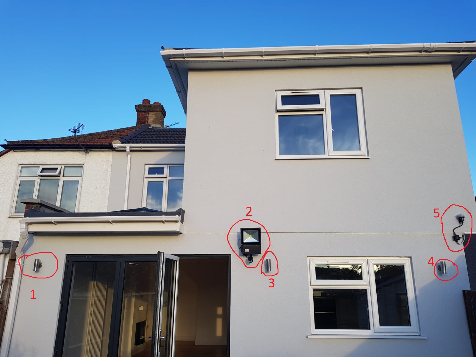

I have not posted any updates here as it has not rained for some months now until, last week and below is a sumary of what happened.
The garden lights were disconnected from the CU.
Since my last post, the drive over lights were my main suspects but they have been on since after it had rained and tey still kept coming on, I even sprayed it with a hose to see if they would trip etc.
On the 28th of July, which was last Saturday I knew the forcast said it would rain, so what I did was to connect up the garden light back to the CU in order to test it, since it would rain the next day. So I connected it. On the 29th of July it rained a lot and hold and behold the CU RCB on the other half tripped. So it looks like its a set of 4 lights. Now, these lights are as pictured three are up and down lights, and on a wall that is not straight/flat, what I did a few months ago was to use clear silicone to seal all around the edges where the up/down meets the wall, the idea was to seal it and ensure that there is no moisture or water ingress. So i did this for light 1,3 and 4.
What should I do now ?

The junction box is probably suspect, given there is a gland on the top side of it. The other suspect would be the dodgy PIR floodlight, but you'll only know by opening up and inspecting all of the fittings.
I'd remove the silicone that you've added. The lights are designed so that any water can drain out without affecting the electrical behaviour. By sealing them up, they'll probably end up filling with water over time.
