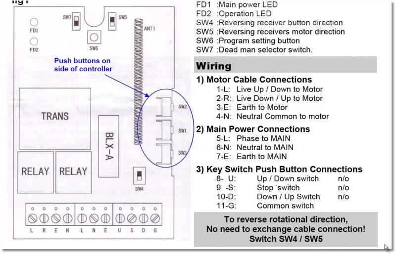

This wont work with a garage door. Most garage doors either have a pair of terminals for open and a pair for close (if one side was commoned this switch would be ok, but depends in the door). Some doors just have a single pair of terminals which you short to open and then short to close. In this case you just want a one way retractive.

I have attached a copy of the info which came with the door controller.
Based on this would I be able to use the 2 Way Retractive Switch from MK ?
Cheers
Hi
Also forgot to say that the controller has been configured for the Deadman mode so as soon as you release the button the door stops, so no need for the Stop switch.
Plan to wire the switch in on the Key Switch terminals.
The main thing is it requires a centre off position and the info is not very plain on this. I did find This PDF which does show grid switches which are centre off never heard of them before but does seem to fit the bill.
Sorry just re-read MK sheet it says K4899 is two way and off so it would seem that is correct switch. I would assume the K4900 is a two way switch without centre off. I may be wrong?
Those switchs do revert back to the centre position when they are released, that is why they are called retractive switches.
