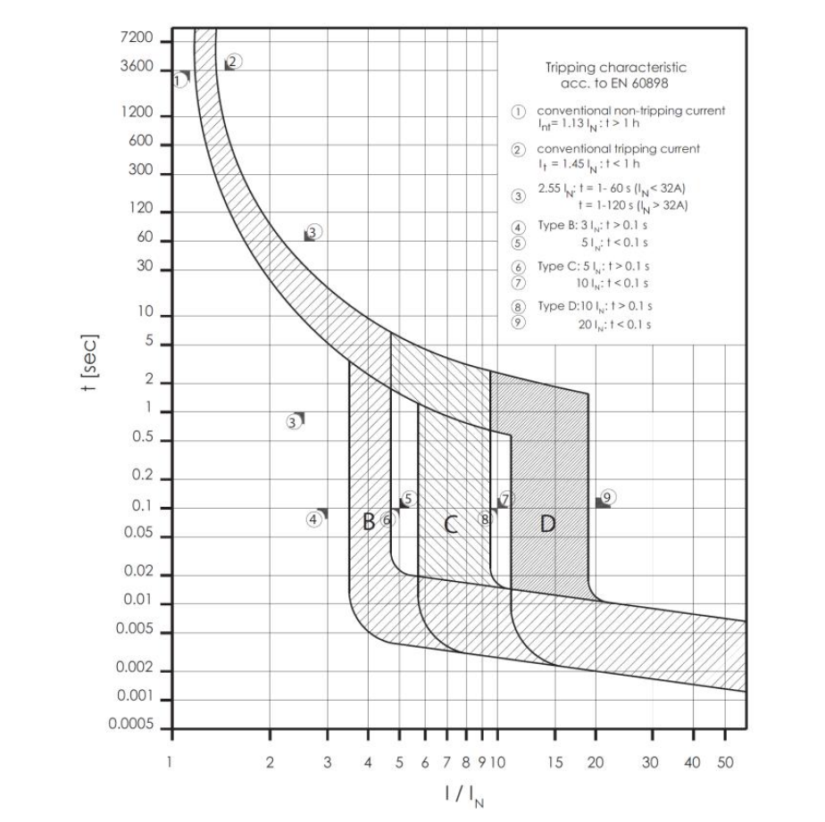

I am working on designing protection devices for my research work and I am struggling to model the thermal part for the low voltage circuit breakers based on IEC standards.
Based on the standards, the time current curve for types B, C and D are as mentioned on the attached figure. I could not find the proper formula which represents the thermal characteristic for these types. Please, assist on this matter.
