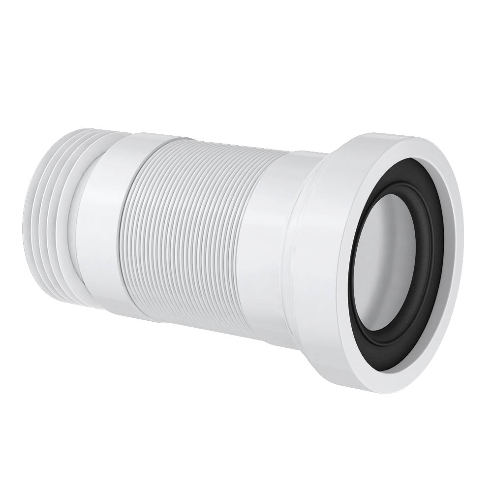

I have a conventional back to the wall toilet with no space to even see the water inlet and soil pipe. I use a flexible braided fill pipe and a flexible connector between the toilet and soil stack. With the whole assembly about a foot away from the wall, I fully extend the flexible soil pipe connector, fit it to the toilet and soil stack and then slide the whole toilet into place and the connector just collapses. Bit of a fiddle but I don’t know of any other way.

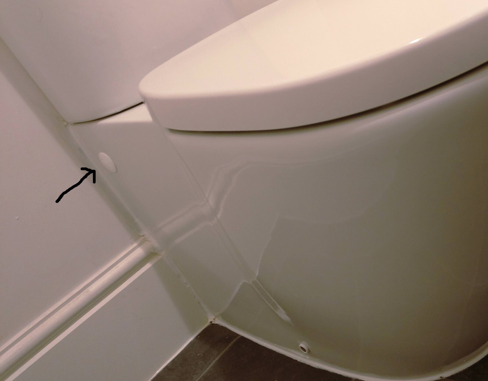

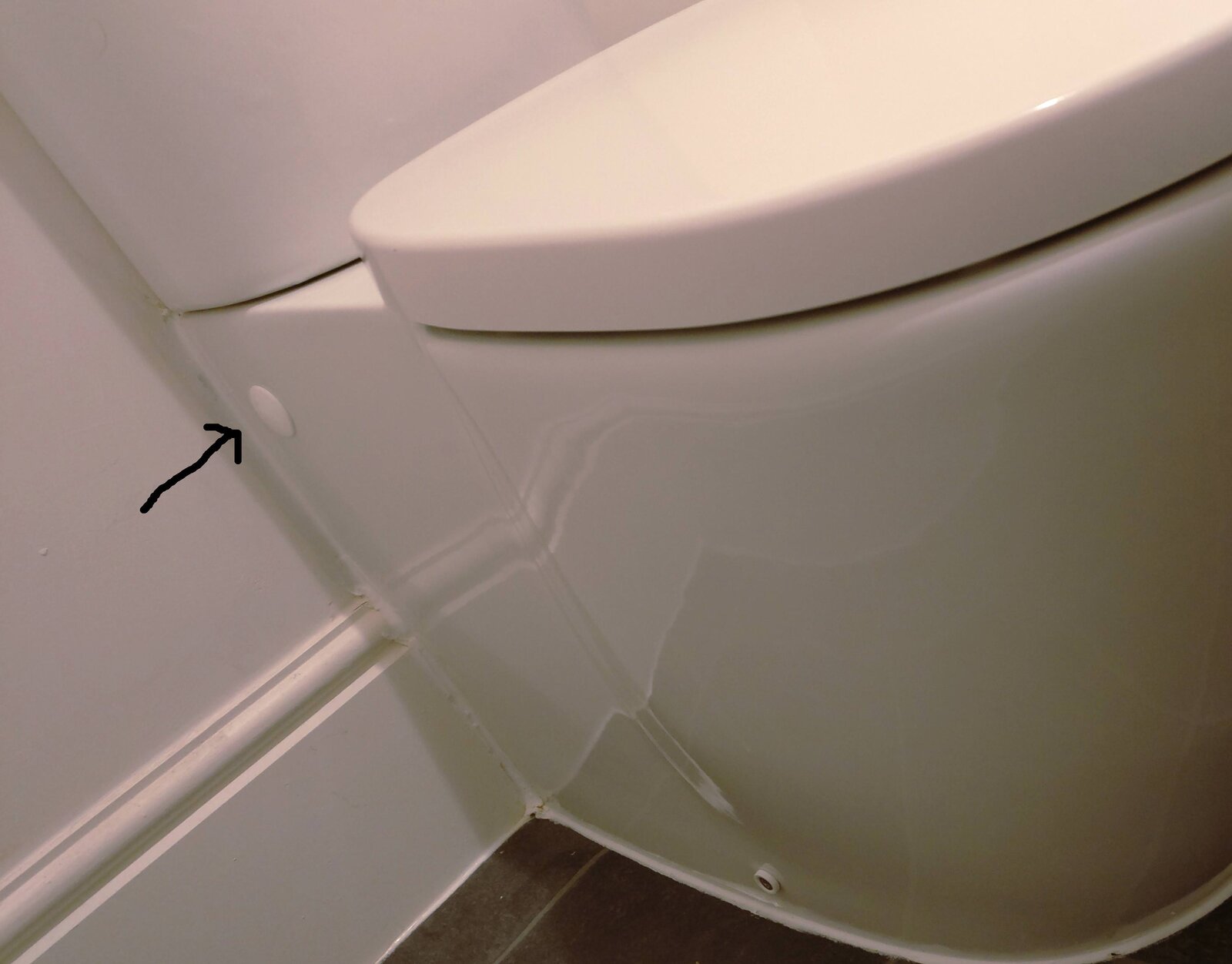

I am fitting a modern back to wall toilet similar to the one on Mottie's post above.
It is located in upstairs bathroom. Wooden floor has been removed as well as old plasterboard, so routing pipe whatever way is best is not a problem.
What is the best practice to connect water supply? from back or through hole on the side (see attached photo i took of the web for illustration )?

if you can fit it to the side like your image shows id do that personally, i fitted these toilets in my house and i assumed they had the side fitting like that but when they came they didnt! What they did have instead was a slight angle on the bottom where it meets the wall which is barely enough to connect a flexi pipe, and in fact actaully keep the toilet away from the wall a fraction. id already routed the pipe as if id known i woud have had to route the inlet behind where the toilet actually is

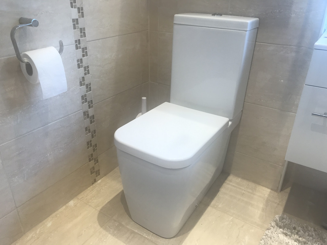

Op, what type of toilet are you refering to. I Could be wrong but Ive always understood a back to wall toilet as being one where only the pan is visible as most if not all close coupled toilets have the cistern back to the wall .Motties looks to me as being close coupled with flush to wall pan?
