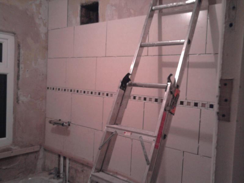

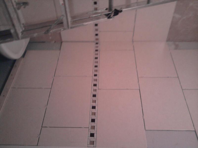

Btw here are some pics of the the work. This was day one.
With tictic on this one, too late for stress M8 :cry: ; gheeze with that size tile you’ve made a serious mistake with your choice of adhesive & thats why your having problems, if you don’t strip while you can, it will come back & bite you before too long & then it will be even more difficult to put right. What weight are those tiles? The suitability of plaster skim is also doubtful; even if they appear to have stuck well, the weight limit is 20 kg/sqm including cement addy at 3-4kg! Unfortunately the grout won’t keep the tiles in place in the longer term & they may well fall off before too long; please don’t say you also PVA’d the tile base!
