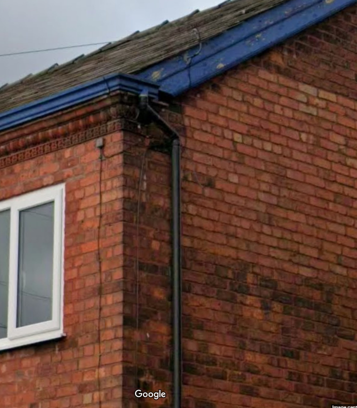

There is some dripping coming from the end of the cast iron gutter in wet weather but I just can't repair it (and been told by professionals that they need replacing with plastic (which I don't really want) as can't be repaired) I have Stormdried up to just above the windowsill but on a ladder and being terrified of heights it's as far as I can go, as well as running out of product which aint cheap. Perhaps get another tub and use a long handled roller.

I expect there would be a way to repair the guttering, you just haven't worked it out yet.
I expect water is getting in to your wall from poor guttering performance. Your downpipe is quite small bore. I would not be surprised if the downpipe was blocked, and water could be backing up in the guttering. I think it's quite likely you do have a water ingress issue, so it would be best to fix that as well.

The downpipe is a replacement of the old rusted cast iron. It was the same bore diameter.
