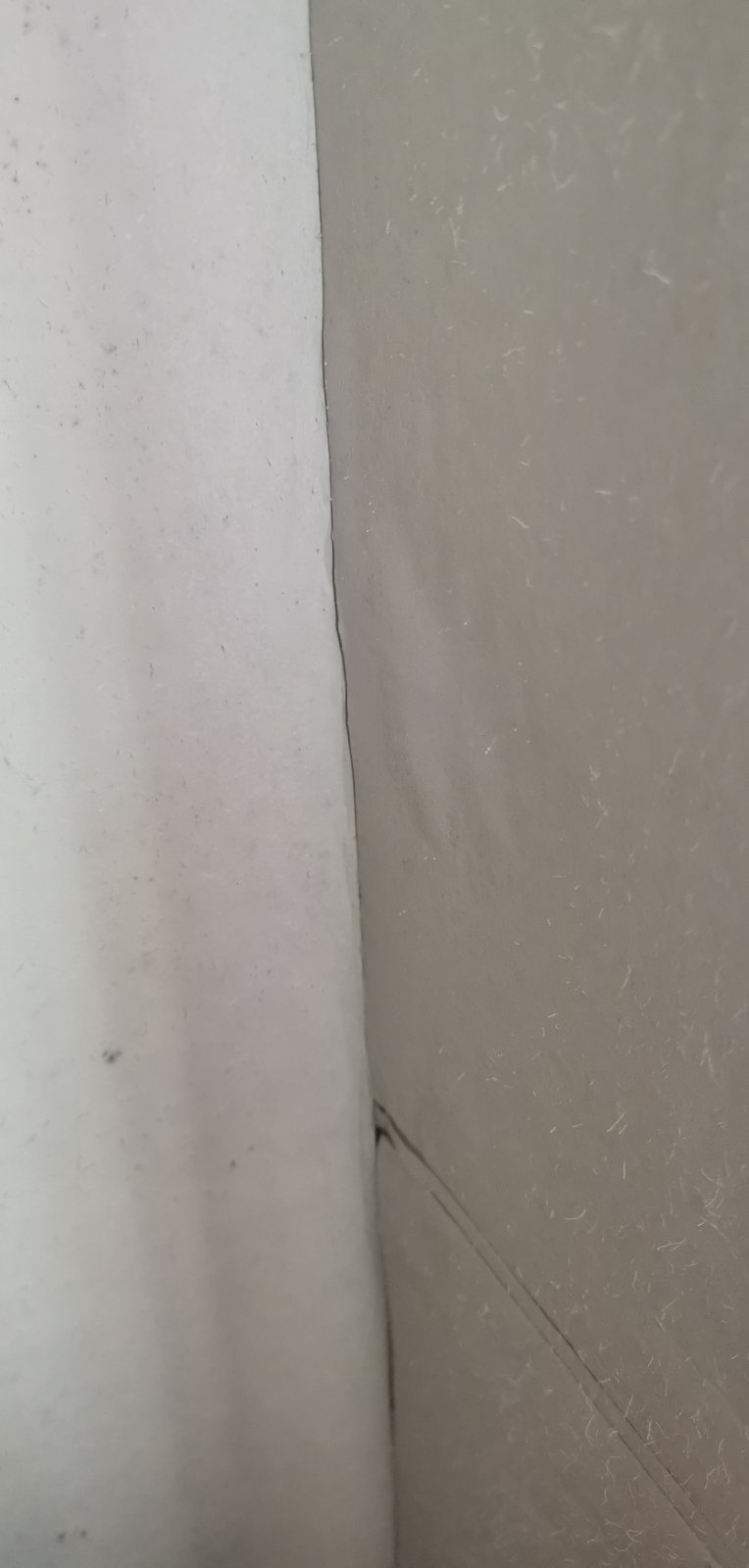

Ok, the gutter was fixed during the dry summer period. It now doesn't leak. have had the bedroom window slightly open as much as possible and yet the paper still feels damp to the tough.
Riddle me that one!
Get air movement with a fan on in the day.
Could take months to dry out fully
Well this just doesn't make sense. The room is aired in the day, dehumidifier runs and no water ingress coming in from outside and yet the corner feels damp, almost wet to the touch. This defies physics and logic
Cold and damp often feel the same, it can be cold and dry but feel damp.
In any case, cold isn't great, as it means condensation could form.
But your window opening and dehumidifier will reduce that likelihood.
Don't forget to heat the space as well, warm air hold the moisture, which then vents out of the window or get trapped in the dehumidifier.
My point being, don't stop using Head & Shoulders just because the dandruff has magically gone away!
Hold a piece of tissue against it and see if it actually gets wet.
Tape some plastic to wall.
If it's wet under you have a damp wall.
If it's wet on top of plastic its condensation

I've just give it an blow with a hairdryer and it seems to work so far.
Well, I just don't understand it as we have dehumidifier, a few of those plastic disposable dehumidifiers, the window ajar in the day and yet it is feeling damp-wet in places. No water on the outside wall at all.

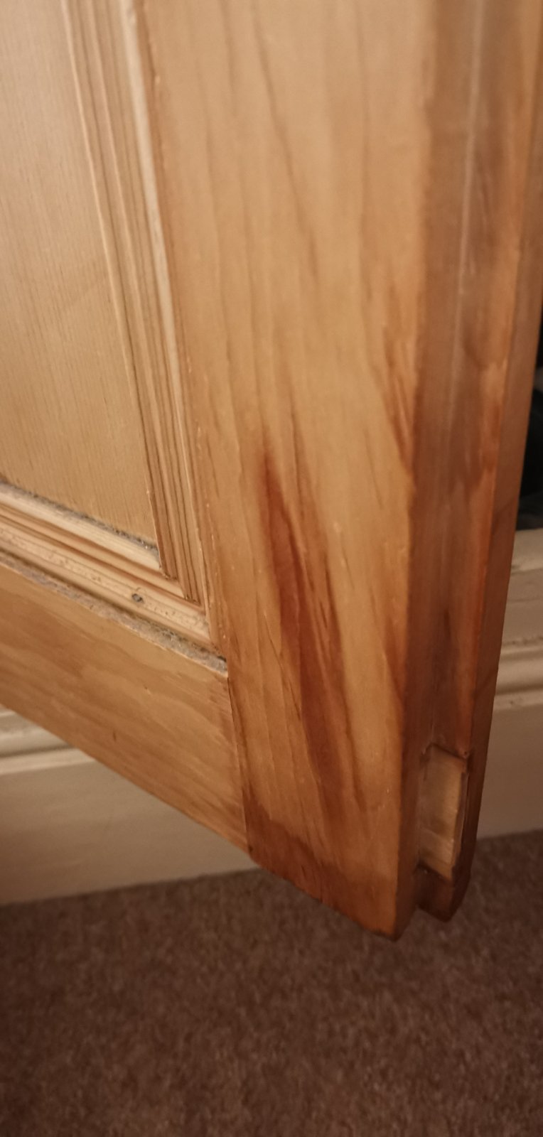

Also, we have old cupboard doors we had dipped and stripped 25 years ago and they still draw moisture to this day, even in summer. I have taken them off in the past summer and jet hosed the wood through to flush out any chemicals (slightly damaging the wood) and still they are in there.
I give up!

I just can't believe the fight I am having DESPITE the electric dehumidifier, having the window slightly open as much as possible and other disposable dehumidifiers dotted around and black mold is starting to appear and the paper feels damp. NO water coming from outside and the air is dry. The THERMAL paper has been stuck with Walrock THERMAL paste and the paper was spray painted over earlier this year with Zinsser Bin stain blocker. This defies physics!
