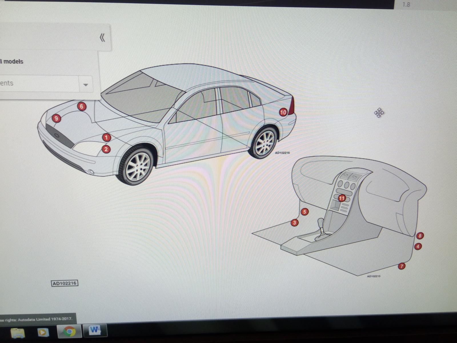

I lost my windscreen washers and its a very frustrating experience trying to track down the fault. I fitted a new pump and checked that the pump runs from a 12 volt supply and it does. I have also fitted a new wiper stalk but still no joy.
The Haynes manual shows an earth point E3 on the "LH rear wing" Do I take this sentence to mean that E3 will be found at the rear on an estate? I have looked at the Front "rear" wing and I cant find an earth point there. Any earth points at the front of the car that I found I have cleaned up. Thank you kindly.

earth point E3
I'd be very surprised if it is an earth fault, unless a stone/corrosion has damaged just that wire. There will be lots of things earthed at each earth point, so you would be experiencing all kinds of others problems too.
That's a point which has only just dawned on me, if it is a two wire pump which spins in either direction for each screen, then it can't have a direct connection to the chassis negative. There's either a relay for it, or the GEM is providing the positive and negative in either polarity itself.
Tried to upload the electrical diagram page from the Haynes manual but failed. I have cleaned the earth points under the hood but I have so far failed to find one at the rear. The interior earth points I hope to do today if the rain stops! The Haynes manual shows washer and wipers as 2 separate systems.
Someone on another forum suggested that the car uses an earth switching method, as is common to many Japanese cars. How GEM works? I am in the dark on that one but when it works, it works its magic fine. I feel really out of my depth trying to puzzle this out as I have no training in electrical engineering. I am limited to cleaning connections and replacing parts.
Trying again to upload a page from the Haynes manual. Seems to have worked this time.

Normal service has been resumed and my washers are now working again. The problem turned out to be damaged wiring from the switch to the pump motor. So my theory that it was an earth problem was not correct.

Thank you John. The wiring fault was between the switch and the pump. The damage looked like if you had struck the wires with a hammer blow or maybe pinched them. I had +12 volts upstream of the damage and nothing down stream to the pump so it had to be the problem, so I thought. Turns out I was right for once. I cut out the damaged section of the wires and spliced in two new one, then shrink wrapped them
What I was finding so hard to get my head around was earth switching. I had never come across that idea before, I did not even know it was possible. With my car, there are two terminals on the pump , and both should have +12 volts at rest. In operation, one or the other terminal is led to ground, depending on which direction the pump is desired to run. Apparently, earth switching is very common on Japanese cars, of which I have not owned one yet. Now I understand how earth switching works, everything seems so simple.
