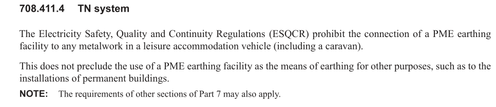

but my understanding is camp sites should be TT and 2P OCPD as we originally fitted.
Correct. Nothing has changed.
Unlike most of the other items in BS7671, connecting a caravan to a PME supply is prohibited by law.
Even if there are no actual caravans, a TN system is still a very poor choice for such a location.
TT with DP protective devices would be the usual arrangement.
Do we think these alterations have been done as the result of an EICR or something, and is there likely to be a report floating around in a drawer that may have the reasons this work was carried out?
