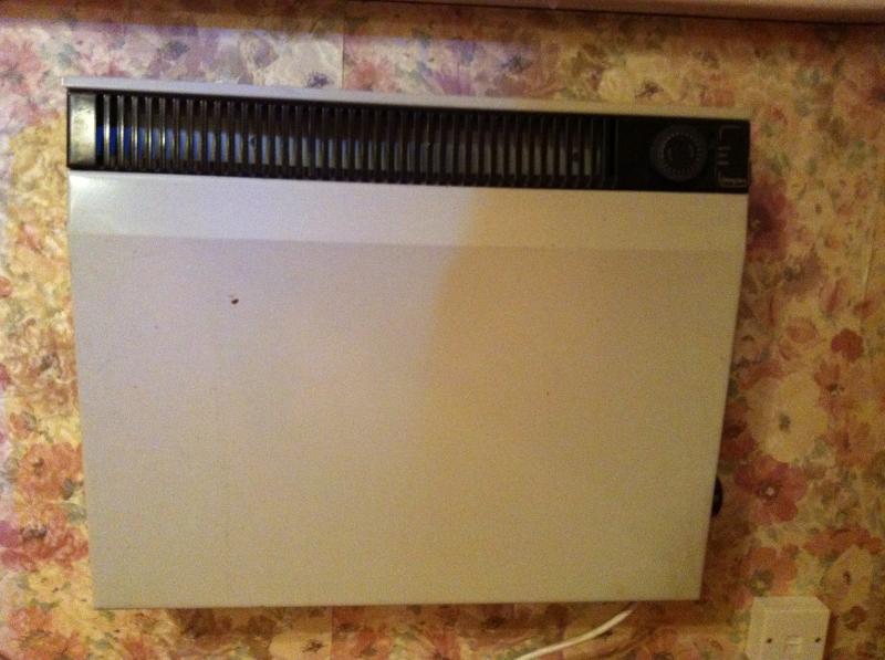

Hello all! Being a noob to electrics could anyone tell me what type of heater this is?
Although this heater outputs heat quite quickly from cold, I'm concerned that in a cold winter it would be uneconomical to run overnight.
But if I replaced it with a storage heater I'm of the understanding that it would not produce heat quickly enough from cold i.e when arriving home on a cold evening.
What would be the most economical type of heater for a bedroom in a flat with electric only, no gas?
Cheers! :)
That's a convector heater.
Storage heating is ok and will save money but only if you have an economy 7 supply, and even then some wiring may be required.
If you're unsure what supply you've got, post a couple of photos of your main incomming cable, meter(s) fuse box(es) etc.
Have a google for electric radiators. They work just like a central heating radiator, but have an electric element built in to do the heating. I have fitted a few of these and been very impressed.

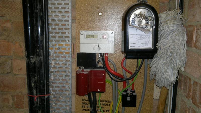

Thanks Rf Lighting and all! I've added a couple of photos of the supply meters.
The new meter seems to be connected to the output of the old meter.
On the new meter is written 'multirate' and '2 rate' - so with this setup will the electricity supply (and all sockets?) automatically switch over to the eco 7 rate at night?
Cheers! :)
Right what you've got there is a dual tarrif meter and a time switch.
The meter is the digital jobbie on the left and the time switch is the old think on the right.
When the time switch is on everything in the property will be supplied with electricity at the cheap rate.
When the time switch switches off, it will disconnect the supply to the off peak board (heaters and immersion) and switch the meter back to standard rate metering.
Thanks RF for clearing that up! It makes more sense now.
Am I right in thinking that the digital meter being newer would also be able to control the timing of eco 7 activation without relying on the old timer switch?
Based on that I assume the old timer's just been left as it provides the cable feed to the off peak board (heaters and immersion)

Check your bill to see what tariff you are on, its not always the case that you have E7 because you have a timeswitch and multirate meter
