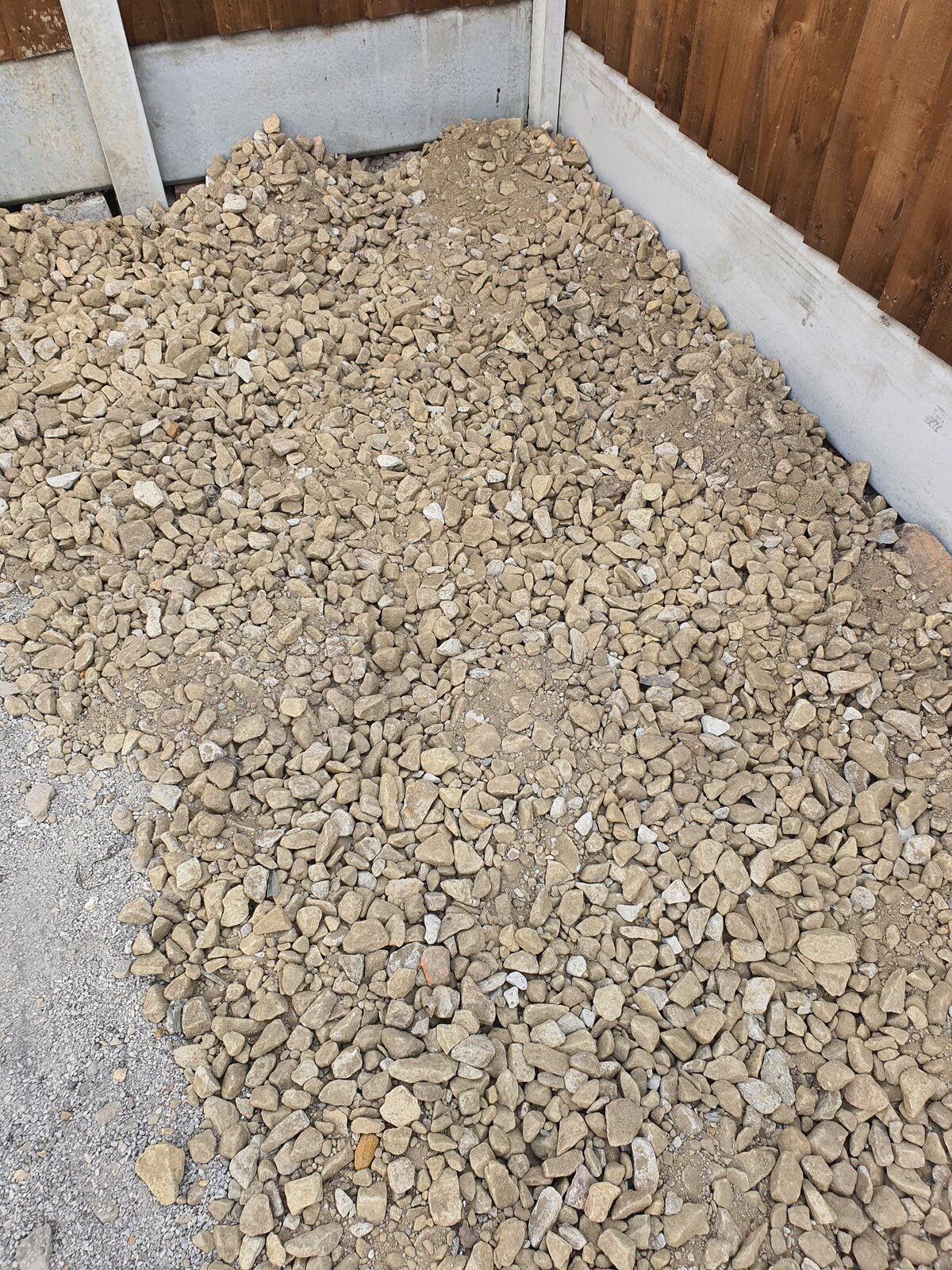

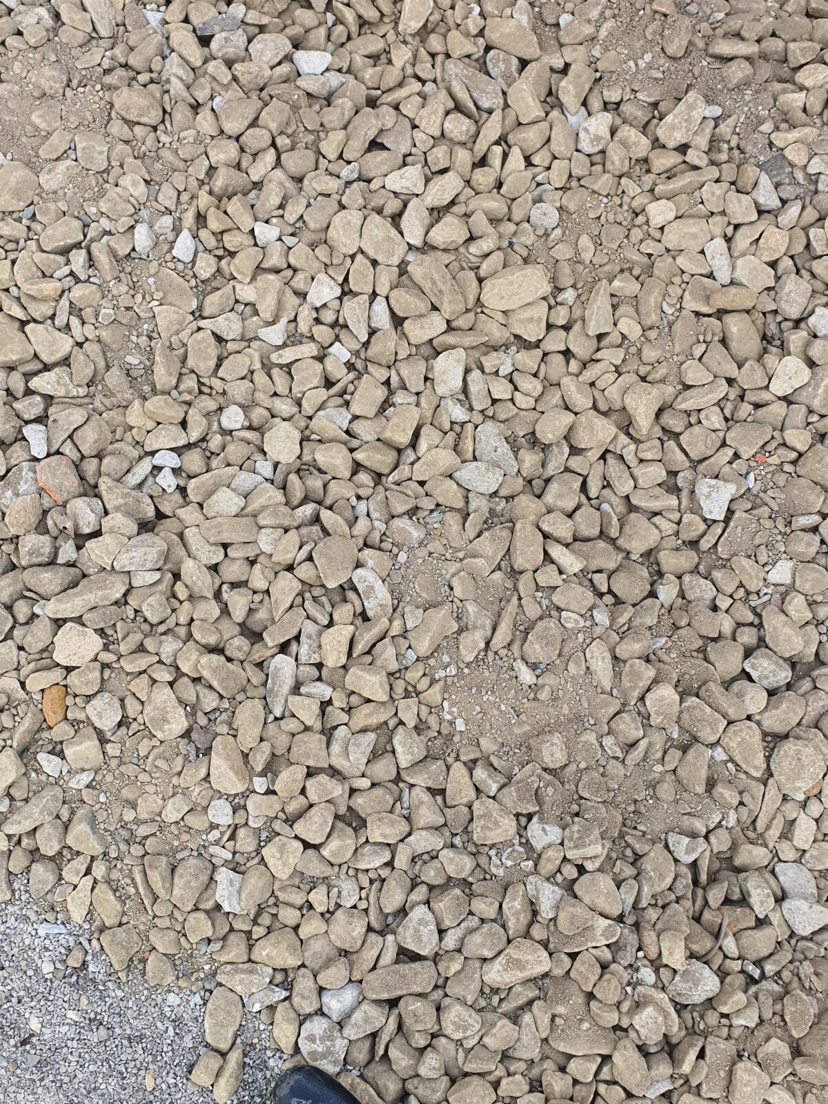

Hello,
Im trying to lay a sub base down and ive ordered quarried MOT type one. It looks different to what i expected. Is this right?
I was going to compact it and lay more on top as im not quite level yet.
Ben

I am definitely no expert, but a Google image search for 'MOT type 1 sub base' shows just what you got! :)
Hahah i hope so, i just expected it to be much finer and less rocky
Not sure it will matter, get it compacted and all should be well, I had a delivery like this, from memory meant to be 40 to dust... more like 100 to dust
That said it compacted a treat and is very solid.
Nice one...im probably going to need some more on top anyway once compacted so il try request finer if possible unless it doesnt matter.
Are you renting a proper compactor? If so you’ll be surprised when you’ve been over it a few times, it will come up smooth.
Yeah, hoping to rent one out next week...i really appreciate you getting back to me. It has been on my mind..
Would you order quarried again or would recycled be better? For the sake of £5 im happy to pay quarried if worth it.
Probably quarried, as recycled could mean there is all sorts of crushed bits in it... that said if it’s for a shed/summer house, doesn’t really matter.
If you are going to put more on top, try to compact the first layer before you add more it just makes the compacting easier.
