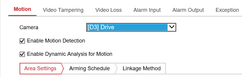

I would like some "intelligence" when playing back footage and have stumbled across this motion detection feature. I was hoping that I would see "Alarm" blocks on my footage and I could then prioritise these. I thought I had configured it appropriately on the applicable camera but it's not behaving as I expected:
In terms of config, the desired camera has the following:
I have also drawn on an area of the screen and raised the sensitivity up to 80.
I've also set the arming schedule as follows:

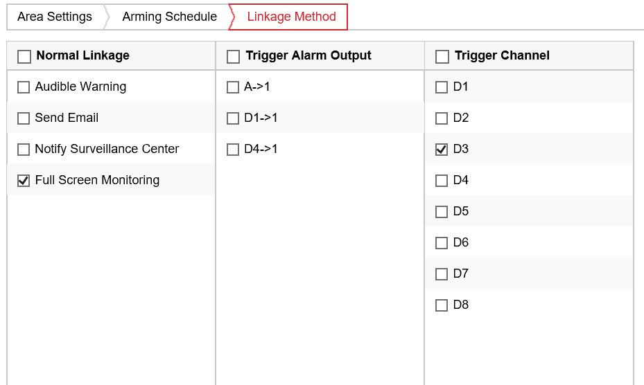

I was unsure on the Linkage Method tab but has set as follows (D3 is the affected camera)
I'd appreciate your advice on this please.

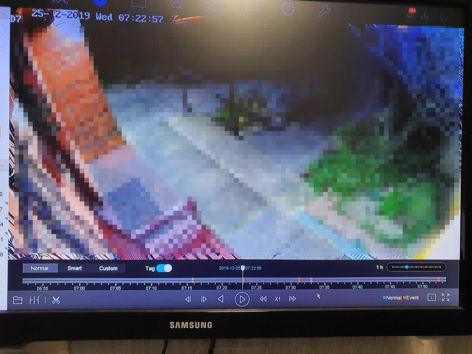

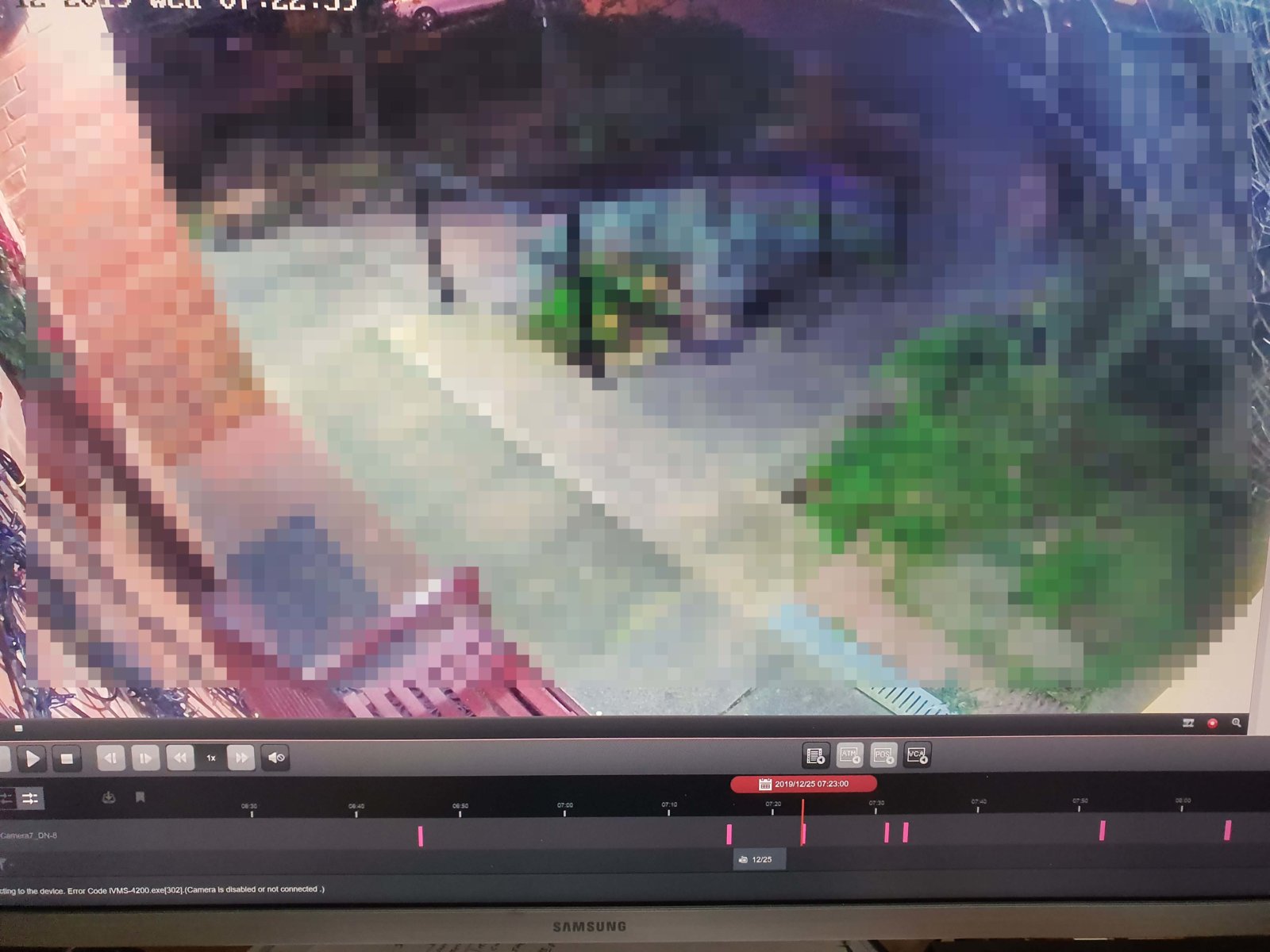

You mean like this? Motion events shown in red on the timeline. (Main image pixellated)

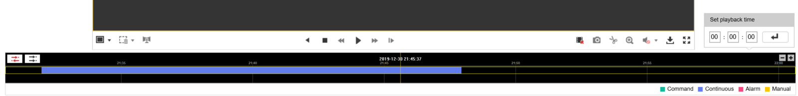

Motion detection is not shown in the playback through a web browser. You need to log directly into the NVR with a screen or use the actual Hikvision app.
I’ve tested on the app and don’t see any motion indication on their either. I know it’s working now as I am receiving emails based on motion detection. Just not seeing the colour coding on the playback timeline...
Sorry I should have been clearer I do not mean the phone app I am talking about the desktop app for MAC/Windows https://www.hikvision.com/en/support/download/software/ivms4200-series/
I use the MAC version and defiantly has motion detection playback on there.
