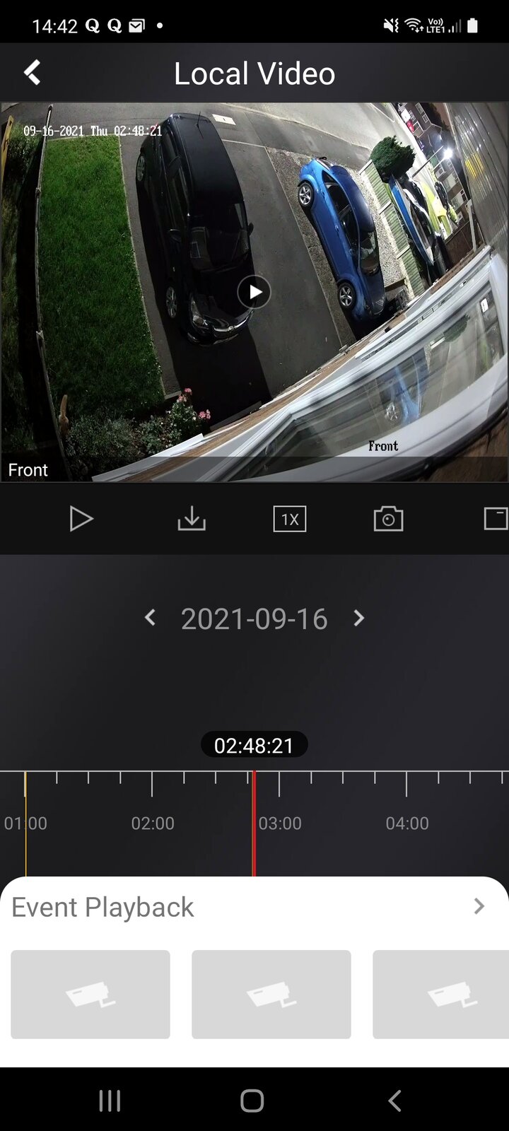

The latest call though has me scratching my head. For lack of a better description, there appear to be jump cuts in some of the motion-detected video.
They got the CCTV because of security worries about their little dog getting pinched. Now though they've taken to watching the wildlife at night in the gardens. Foxes and hedgehogs. Occasionally a small critter will stop to smell the roses so to speak, and then appear to vanish like the motion detect stopped detecting. Does that make sense?
I have seen tis myself on the remote playback via my Android phone.

It might be that the motion detection algorithm does not react to an object that is apparently changing size without actually moving across the image.
The image of a small animal that moves towards or away from the camera would change size but not position.

I understand what you mean by changing in size but not position.
Here's a shot of foxy having a sniff at a bush (oo-er). You can just make out his rear haunches and tail. The head and from legs are obscured from view. It had walked along the fence line, so across the field of view before stopping.

I wondered about whether this was a glitch in the playback feed to smartphones / tablets. However, the disappear trick happens at exactly the same time it's played regardless of the start point. My gut tells me that this is missing footage rather than some footage that got obscured because of an Internet speed glitch. Would that be a sensible conclusion, or am I missing something fundamental here that affects CCTV but not so much YouTube and streaming? I will check on the local monitor though when I call to site.
You mentioned bandwidth limits for upload speed. Is this simply their Internet service limit for uploads, or is there more to it than that? Do I need to factor in anything else?
Recording motion detection with a higher sensitivity got them lots of activity, but that became a complaint. Okay, so we turned it down, but now there's a chance that something stationary for a while will drop off the motion detection activation; is that about it?
I can increase the pre and post padding I think. Probably post is more useful.
I wonder if the number of pixels affected by the fox was too low to invoke the motion detection.
I agree with secureiam that recording everything, ( not waiting for motion ) and then manually scanning for the incident is the best way.

sounds like the motion is activated your getting your motion recorded, but its cut short you can change the settings usually on how much is recorded prior and after activation this may help.
bandwidth on a 4ch is 40Mbps, the more active a scene is the higher the bandwidth will be.
you can see how much is being used in system, maintenance, diagnose, view stats, you can reduce the bandwidth by greater compression, lower quality, lower frame rate lower resolution.

You've all mentioned having the recorder set to record permanently, but then to "search for a specific event". I take it then there's some better way to set up the NVR so that it flags what would be motion detections as markers on the time line? What's the feature I'm looking for for that?
You can set the Hikvision NVR to record permanently AND detect movement. On playback you see the movements highlighted but if that fails you can still scan between them.
