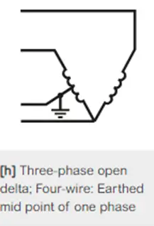

For my "day job" my employer builds & ships educational equipment to many countries, including the Philippines. Our standard config is 220V single phase & 220V L-L 3 phase for the Philippines.
... and I obviously cannot argue with your employer, who presumably is selling equipment which can be used by the buyers! However, as a matter of interest, what proportion of the total is represented by the "220V L-L 3-phase"?
That's a pretty bizarre one, and certainly not something I've ever come across. What is the thinking behind that? What is the phase difference between the two main phases?
