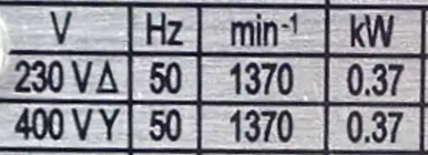

Motor rating plate
A few motor plates the all suggest the delta is the 230 and Star 400?

Maybe it's just me, but I am becoming increasing confused by these rating plates. Things like ...
...only make sense (to me) if all the voltages being mentioned are phase-to-phase ones - yet, as we have agreed, supplies with 230V phase-to-phase don't exist in the UK, if anywhere (and this one is distributed by a UK company, so presumably intended for use in UK).
Can someone help to unconfuse me? What am I missing?

Exactly .... a common way to supply a small (upto about 3HP) 3 phase induction motor is to take a 'standard' three phase motor, which expects 400V L-L in STAR config & flip into DELTA - the motor is then good for 220V L-L.
There are a considerable number of VFDs on the market that take in 230V 1ph & output 220V L-L 3 phase (ie. they don't step-up the voltage just create the other two phases). With the motor configured in delta it is compatible with the VFD & allows it be used from a 'normal' single phase supply.
A motor which expects to be STAR/DELTA started with a 400V L-L supply would be a 400/690V motor. This would usually be above around 5HP. The windings would be configured in STAR for starting (ie 230V across a winding which 'expects' 400V - hence a lower starting current) and then automatically changed into DELTA (giving 400V across the same winding = 'full power') after a few seconds.

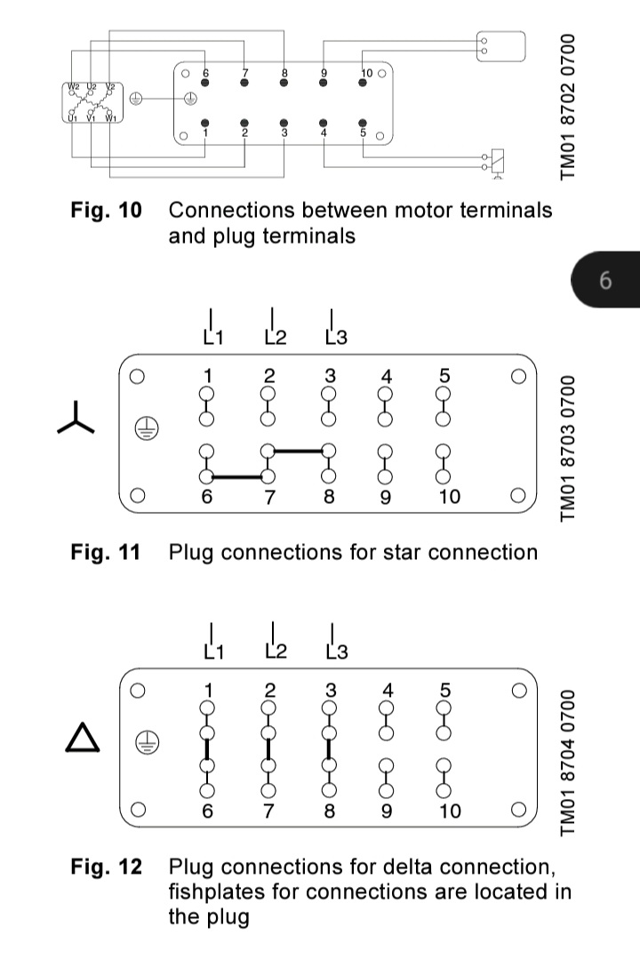

Taking a typical Grundfos pump with a similar rating plate -

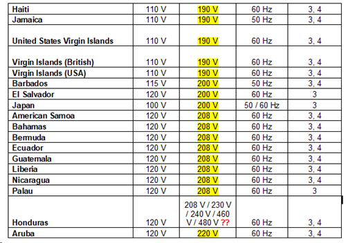

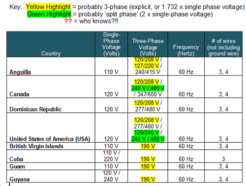

Mr Google directed me to (this site) , which attempts to list the single-phase and 3-phase supply voltages of hundreds of countries, albeit a bit confusing. Of thouse 'hundreds', there are about 37 countries for which a 3-phase voltage less than 380V is mentioned. In the extract below, I have highlighted in yellow those which probably are the phase-to-phase voltages of 3-phase supplies, either because they are 'explicit' (e.g. "120/208V") or when the stated 3-phase voltage is exactly, or roughly, 1.732 times the stated single-phase voltage.
None of those 37 countries are in Europe, most (of the ones I've heard of!) seemingly being in Central/South America or the Caribbean. Although both Canada and USA are said to have 120/208V supplies, I suspect that they are very rare in those countries. I have highlighted in green those which look as if they are probably 'split phase' supplies.
Kind Regards, John

Sorry, when I said... .... I meant the voltage to the pump connection terminals - i.e. in star the voltage would be across "windings", if that makes sense? ...
I think we are probably agreed that if one takes a motor designed for 230/400V in 'star' configuration, it will work essentially the same if it is changed to 'delta' configuration and fed from a 133/230V supply.

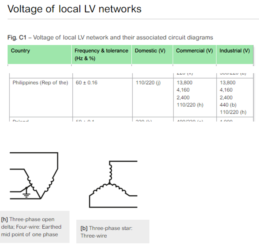

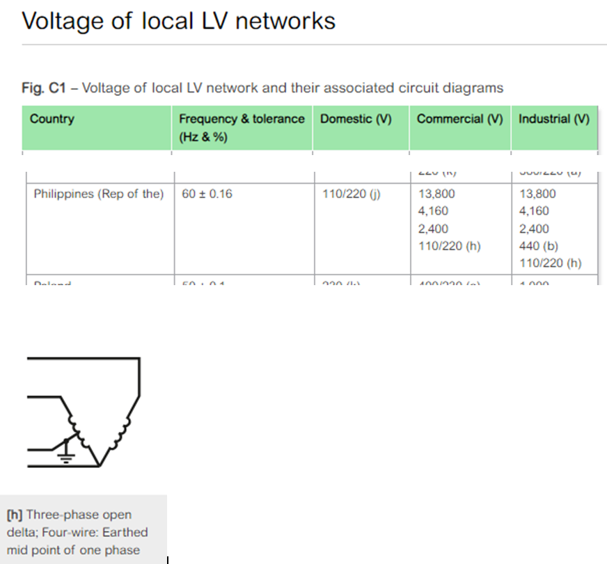

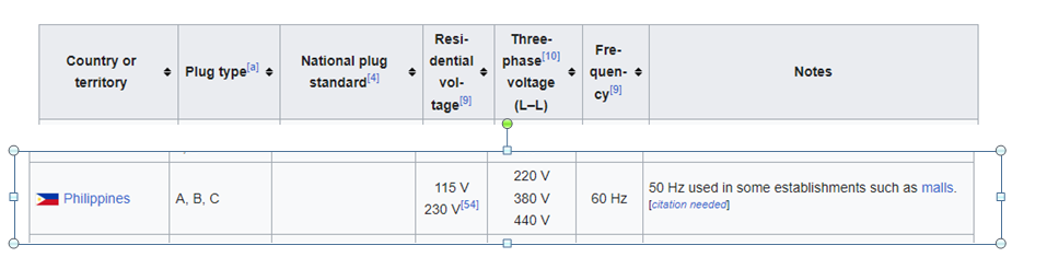

220V L-L supplies do exist. This Philippines, for example, has delta supply - 3 phase & ground.
A 'single' phase supply is two legs of the 3 (ie. no NEUTRAL, both legs are ungrounded) so double pole switching is needed.
It takes a bit of getting your head around, since the single phase voltage is the same as the three phase voltage! We aren't used to that with our STAR type sources.

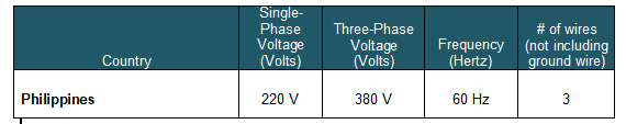

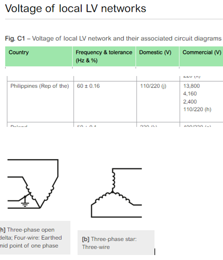

220V L-L supplies do exist. This Philippines, for example, has delta supply - 3 phase & ground. A 'single' phase supply is two legs of the 3 (ie. no NEUTRAL, both legs are ungrounded) so double pole switching is needed.
Is this perhaps a case of "don't believe everything you find on the Internet? ...
Kind Regards, John
Kind Regards, John
Definitely!
For my "day job" my employer builds & ships educational equipment to many countries, including the Philippines. Our standard config is 220V single phase & 220V L-L 3 phase for the Philippines.
We are spoilt here in the UK in that we've all grown up with a system where is just one LV service 230/400V 40Hz. Thats just not the case in alot of Countries - there are many possible services depending upon the region.
