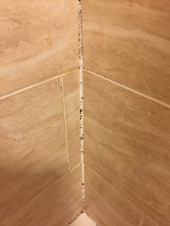

Hi folks,
For the love of humanity can somebody advise as to how I can shift this mould in the shower.
Cubicle and tiling are only four years old with anti-mould sealant!
Any advise gratefully received.
Cheers.
Bleach will do wonders on the grout, rub it well in neat with a kitchen sponge using the scourer side, leave it overnight and wash it off. As for the silicone, replacement is the only solution. As annoying as it might seem, drying after every single shower will reduce the chances of it reoccurring.
For the grout, spray bleach and a small scrubbing brush. Do it in sections and rinse down after each section or you will stain the tiles, (even plain white ones!).
For the sealant, as stated, only solution is to cut out and re-seal with a good quality brand. It may also help to rinse the shower down after use to remove any soap/gel residues.
Melamine sponges work really well on grout.
Silicone - replace with a good quality anti mould one (I've tried cheap anti mould ones and they didn't last a year)
Easier to prevent it by keeping the shower well ventilated, good quality extractor fan above is a must.
'Astonish' for mould and mildew- you get it in 'Home Bargains' type shops. Spray it on , leave it for a while and then rinse.
Mightn't get rid of all, but i find it good.
The product you need is called Muffycid. Sounds funny but will bring it up like new within an hour.
Just spray it on and leave it. Scrubbing spreads the spores.
Doesn't matter how expensive the silicone is, mould will eventually take over if the room is not well ventilated.

One of the simplest solutions to help stop the mould is to rinse the shower area with cold water thoroughly after each use, and clean it regularly!, Once a week with a sponge and soapy water will suffice, doesn't have to be with harsh chemicals, you can do it while you're in the shower too so saving time on another chore. And as previously advised correct ventilation is a must, try fitting a humidistat fan to help with the problem
