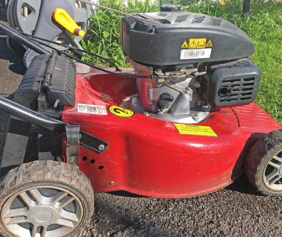

Ive been cutting grass for a few years now & all my neighbours think im a mower man repair guy hence why ive been given another mower to look at.
This time its a Mountfield SP454 & overall its in very good shape / condition.
Lady told me it just died & wouldnt start again then left in a dry garage for a month.
I drained the fuel into a clear jar & i could see water & other jelly fish type algae etc not to mention it did smell like turps as opposed to petrol.
I removed the carb & confirm the float works fine also the needle jet below moves up / down fine.
The main jet down the long brass tube is now clear & free to blow through.
The inlet pipe where the fuel pipe connects is also clear to blow through.
The air filter has been washed, cleaned & dried.
A new plug has been fitted.
It has a red primer bulb with a hole in the top & it fits into the air filter which when i press it feels like nothing is happening.
If i then press harder / deeper so i can feel the plastic case to which it connects i then hear a noise in the fuel tank & i then feel a different feeling.
So much so i can say its now doing what its supposed to do BUT only because im pressing harder / further into the bulb.
This cant be right as i wouldnt expect a women to do it like ive been doing.
Second pull the mower starts but it runs for say 10 seconds & then dies.
If i repeat the same process it does the same thing.
So it will not continue to run & just drink the amount i pump then dies im saying that as i cant see tickover beeing low as lady owner wouldnt of known what to touch.
Does this seem like the gasket between carb / air filter not creating a seal so no continuous vacuum or do you know if these primer buls have an issue.
I dont see any leaks from primer bulb BUT now & then i do see fuel on the mower deck right below carb / air filter
I dont see any pipes connected to primer bulb so it must just work through a series of holes to get fuel from tank into carb
I would of done a short video clip but doesnt run long enough for me to do so

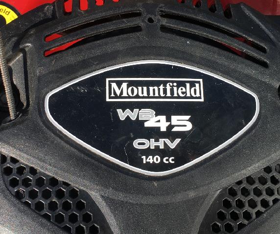

Today the gasket arrived & I’ve now fitted it. I press the primer twice & pull the starter rope. Same as before where the mower starts but only runs for say 5 seconds & then dies.
Fuel filter in tank has been cleaned.
New fuel pipe fitted from tank to carb.
Pull off pipe at carb & petrol fun’s out fine.
I can blow through carb pipes & jets so nothing is blocked.
Air filter is clean.
New spark plug.
Fresh fuel
Today I even removed the exhaust just to rule out it being blocked but same issue.
Lost & confused as to what it can be.
I supply some photos should you see something wrong or missing.
Also can I screw anything in or adjust anything to at least get it to run longer as to rule things out ?
Thanks.

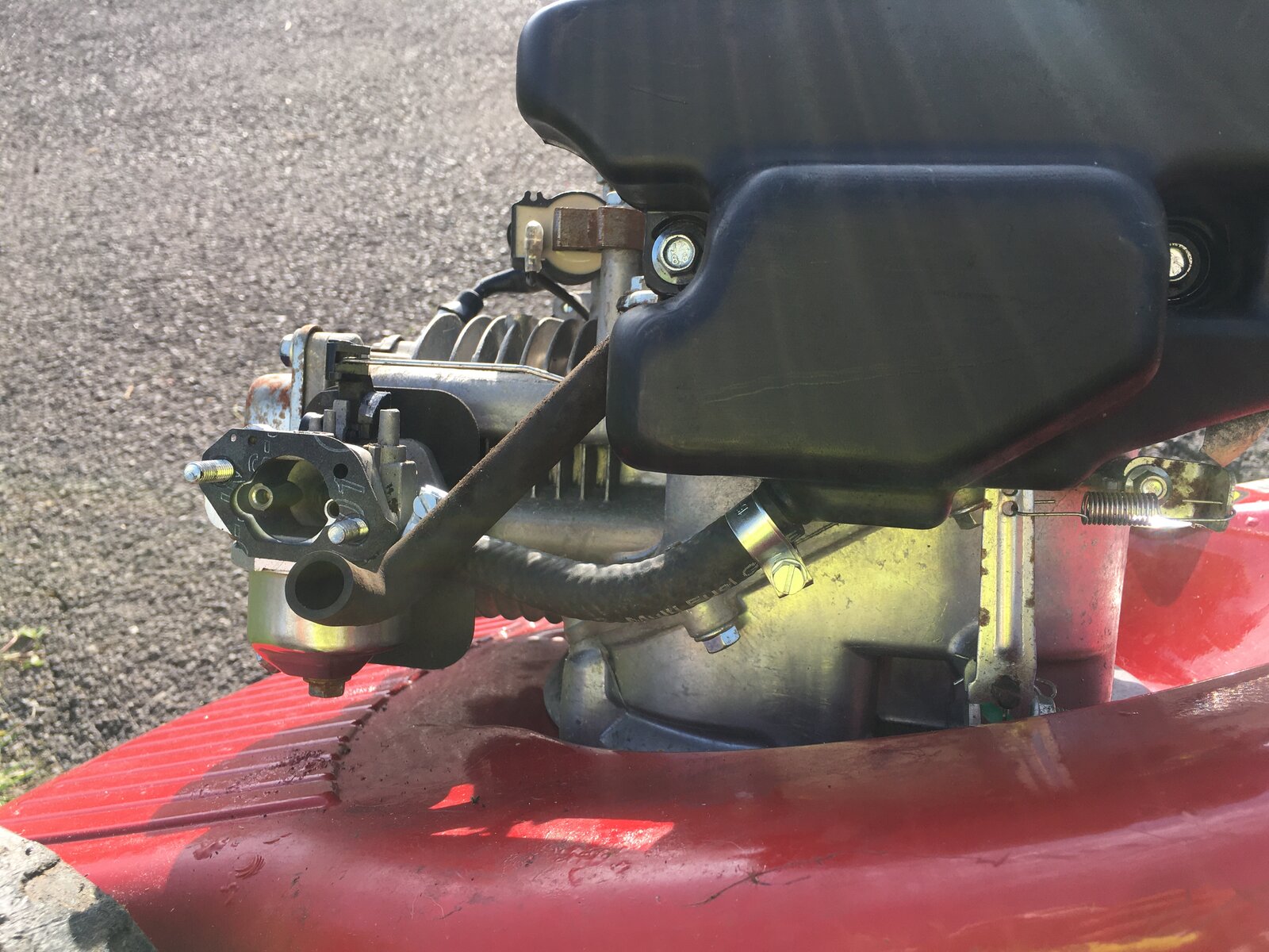

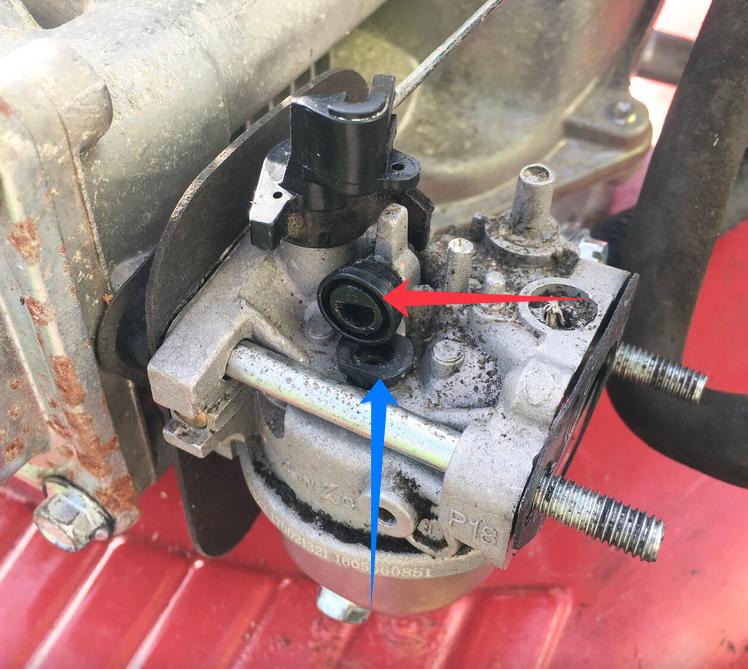

Can you see in picture 2, the round plastic tick over screw?
Below that is the plastic slow running jet which can be prised out for a clean, after the tickover screw is removed.
Plenty of carb cleaner needed here, compressed air helps too!
John
So remove & clean item by blue arrow
OK
ive removed that plastic part & the small hole is blocked
At the bottom is a brass part, i assume that needs to be clear
Yes it does, and there is a drilling connection from one of the small holes shown in picture 1.
Squirt plenty of carb cleaner down there!
John
Wont budge.
My needle jet cleaner will go in so far & thats it.
So not sure if its same size hole all the way through or tapered.
Compressed air does nothing
It’s well blocked.
I’ve removed it from the plastic part as had no choice.
Any reason why I can’t leave it out & just refit the black plastic part ?
Done.
I cut away a little of the plastic that the brass jet passes through.
Managed to get a hole through it & see daylight.
Put it back into the black part & touched edges with soldering iron & made a good contact with black plastic & brass part.
Short video.
I’ve never removed the brass jet before, or altered the plastic insert!
