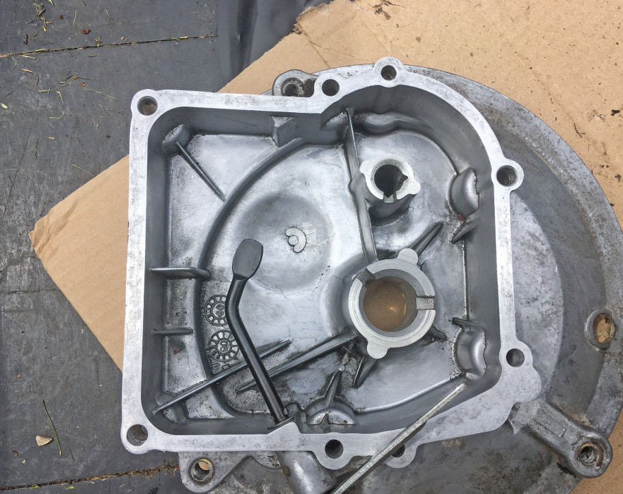

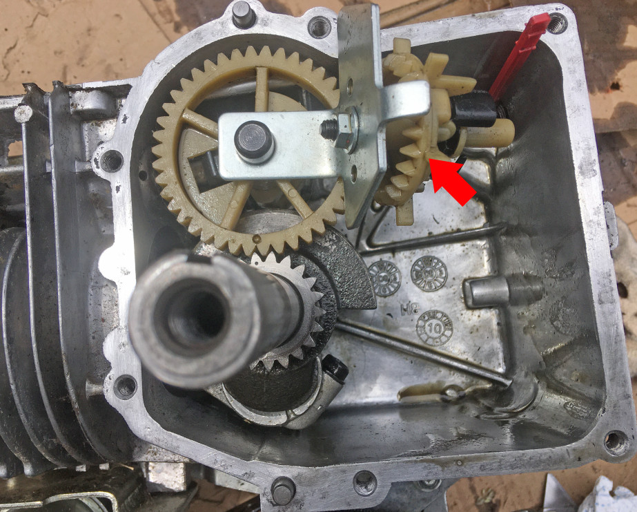

Ok,
Ive cleaned it up & now its off.
Nothing broken inside the case.
I removed the springs / valves & valve seats are intact so ive put them back now.
I then cleaned & fitted the 2 valve tappets,things like from a trumpet etc.
Nothing broken on the plastic cam gear either.
I rotated the crank & placed the plastic cam into place so the 2 dots on the cam / crank gear line up.
Ive attached 2 photos for you.
There is a cogged wheel which must i assume sit ontop the cam & held in place when i put the cover back on, is that correct like how i have it ?
