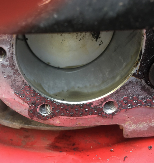

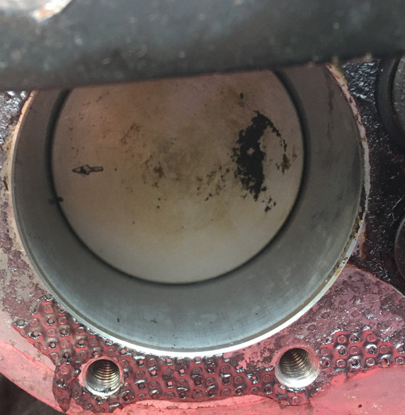

The presence of oil on top of the piston may still be residue from when it was tipped over and hasn't been started to burn it off.
No.
With the mower tilted back a touch & turning the blade around i see after a few turns oil in the bore.
One i dont see how the oil can go up hill but two isnt the oil scraper ring supposed to stop oil passing anyway ?
The oil isnt on top the piston but in the bore.
Ive cleaned it off but after a few spins its there again.
See attached photos of when i cleaned it then spun it a few times.

That amount of oil isn't a problem, so long as the engine isn't over full. It will burn away when the engine starts.
Before you pop the head back on, give the engine a good few pulls just to ensure the valve seats aren't jumping....on occasion they can drop back into place.
John :)
