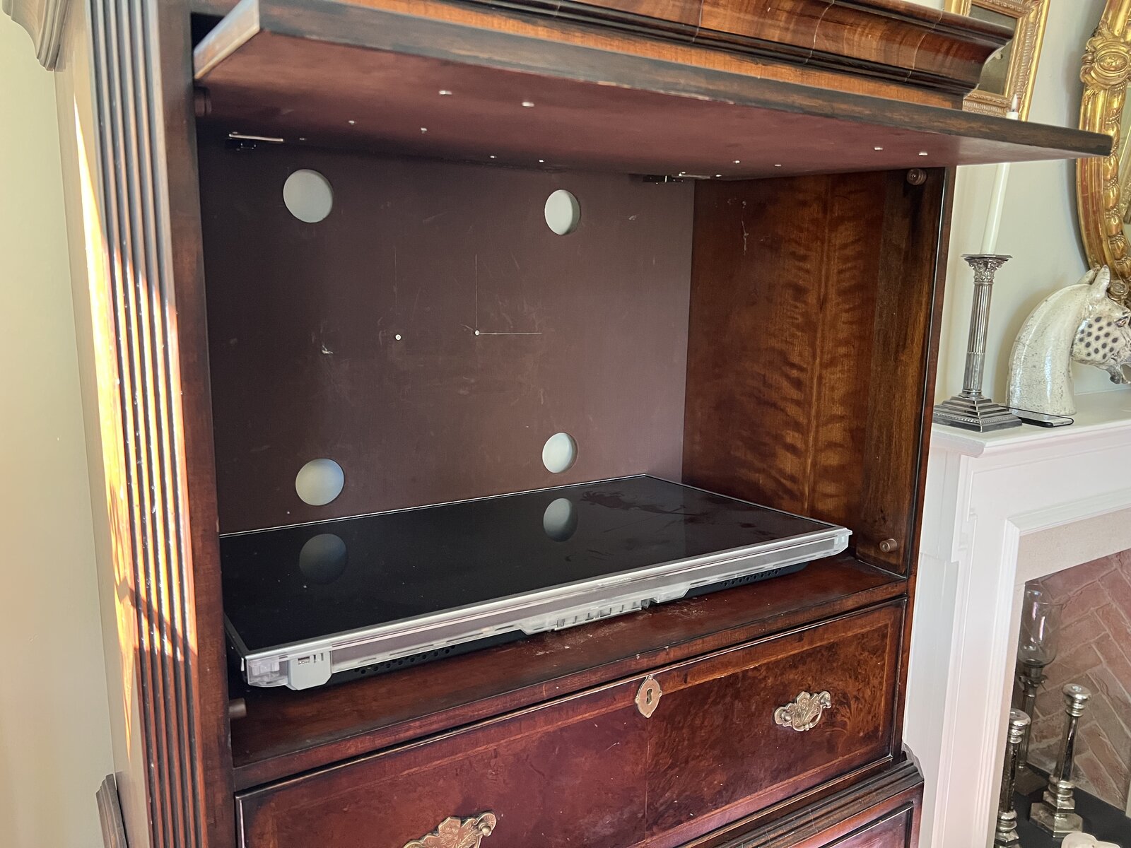

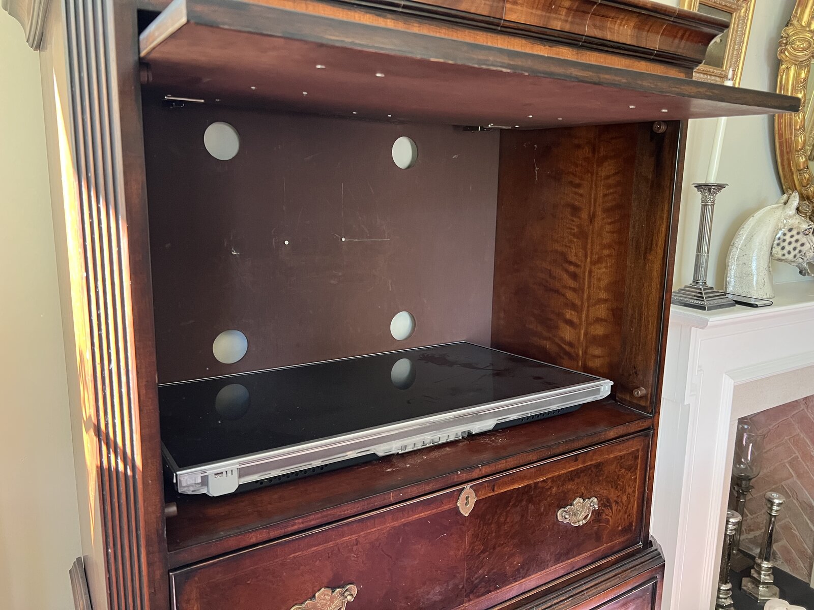

I have been asked by my old man to mount a TV on an articulating arm inside a piece of furniture (Antique style, modern joinery, well built and heavy weight construction).
The unit originally had a much smaller (15inch) TV inside it on a sliding turn table. Dad now wants a bigger TV installed inside it, and due to its position in the room wants it on an articulating arm.
I need to come up with a solution that isn't destructive (some screwing is ok), and wont tip / destabilise the whole unit over when the arm is extended.
Apologies for the crap photo - this is the unit and the space the TV needs to sit in taken face on.
The back panel is 11mm ply. It is rebated into the body of the unit.
My concern is bolting an articulating swing arm and TV to 11mm ply is probably going to end in a disaster, with the arm ripping out of the back at some point.
I have been trying to come up with a possible solution, but interested to know if anyone has an idea on how this could be done?

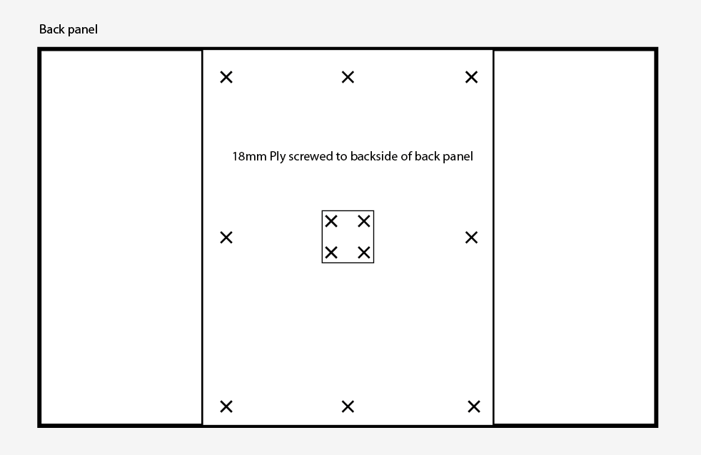

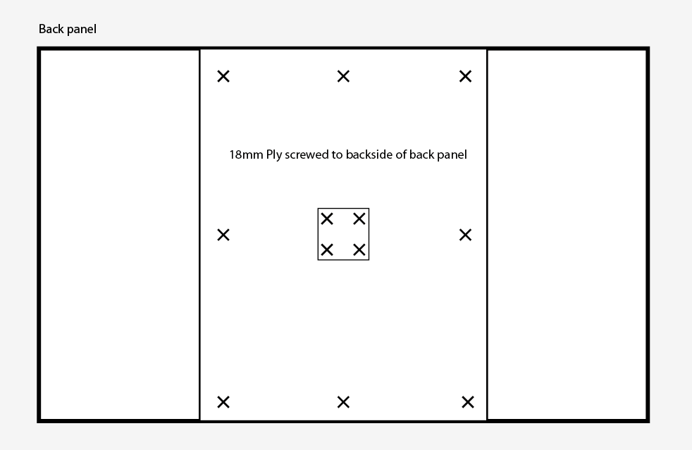

  1. Cut and attach 18mm ply to the backside of the 11mm ply, then bolt the tv mount through both bits of ply. Hopefully the near 30mm thickness of ply will support a TV with the arm at full extension.

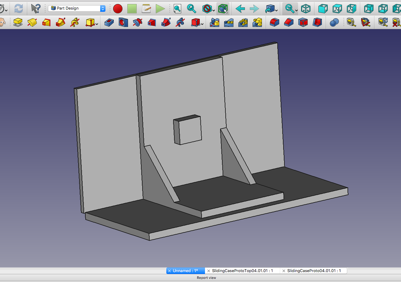

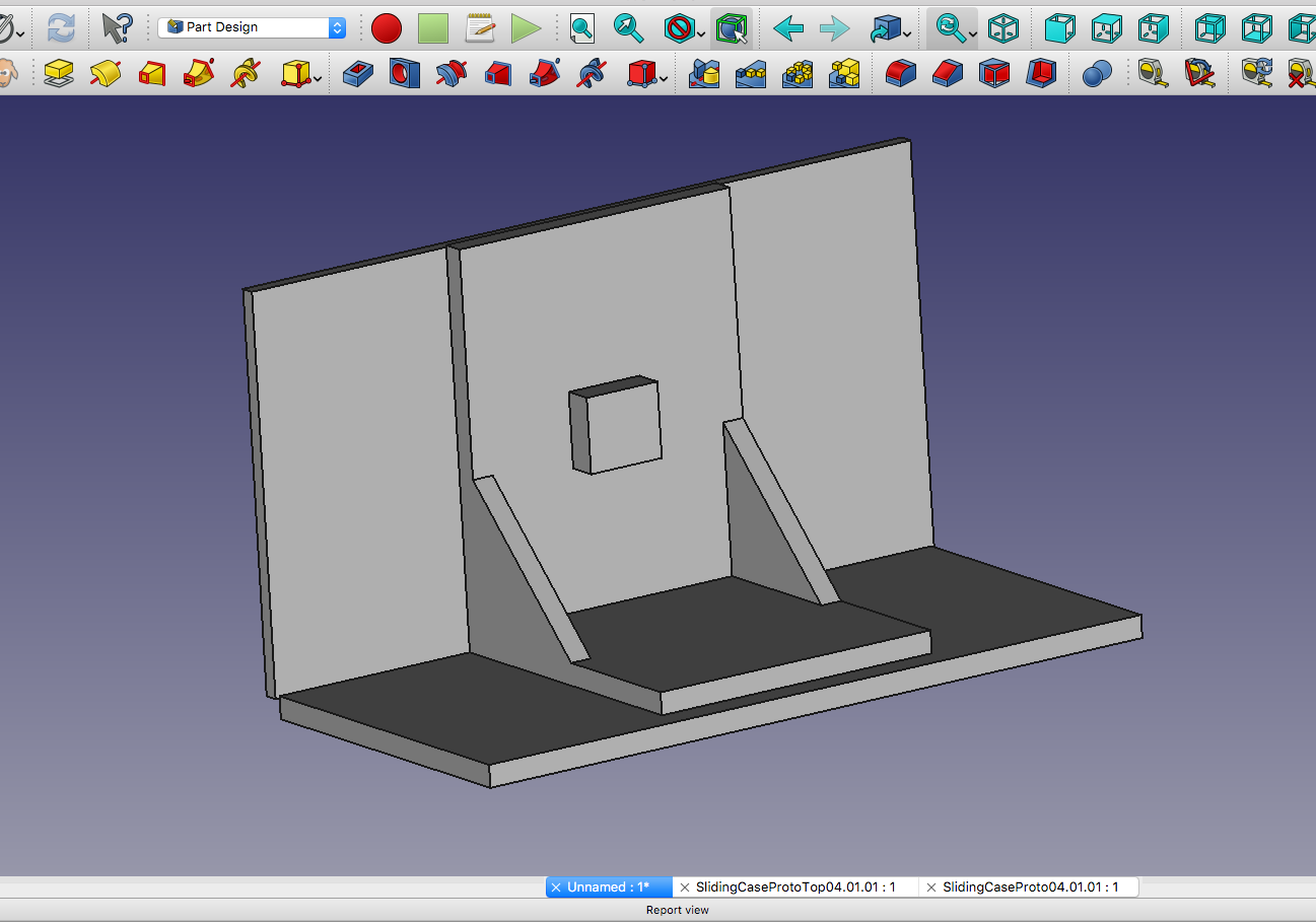

  1. Make a L shaped stand with triangular bracing out of 18mm ply that sits in the available space, and is screwed to the 11mm ply, and also screwed into the bottom shelf. Then bolt the tv mount through both bits of ply. Hopefully this way the weight of the TV on the articulating arm is being shared by the back and the lower shelf.

into the wall behind with say 20/30mm spacers unconnected to the cabinet just through holes at the back
Just a 4x2 across the rear will easily hold the weight. You idea way OTT .
Yes, this will work too, but I would also secure the unit to the wall by something more substantial than the 11mm backing.
You can’t get anything heavy enough inside a small cabinet like that for it to need securing into the wall.
My entire workshop walls are 11mm osb and easily support all my shelving and tools and fittings and worktops.
A tiny tv on a bracket is an easy fix.

TV that is going inside the cabinet is a 32 inch, its not spectacularly heavy (4.5 to 7kgs depending on tv) but it weighs enough to cause concern, especially if the display arm is extended out.
Screwing a 4x2 or similar to the wall and then screwing through the backboard into that is a solid suggestion and would have been my preference, but the old man appears unhappy with the suggestion as he is concerned about the 4x2 being visible when the unit is viewed side on.
I didn't mention it in the original post but the unit is in two separate sections. If you look to the bottom of the first image would can see where the two halves come together. So tipping is a concern.
Having read the replies and mulled over some options. I think a discreet option would be to apply some flat brackets to bottom of the back panel, anchoring the top half to the bottom half, then adding some discreet metal L brackets to the top of the unit which I can fix into the wall. This will hopefully prevent any possibility of the unit tipping - by anchoring the top of the unit to the wall and the bottom to the substantial base unit
I know it also seems overkill but I think I will make the internal L shaped stand. I think it will help spread the load within the unit across the back panel and the shelf below. I also have the materials to hand and its no great undertaking to produce. It also means that everything is contained inside the unit itself.
