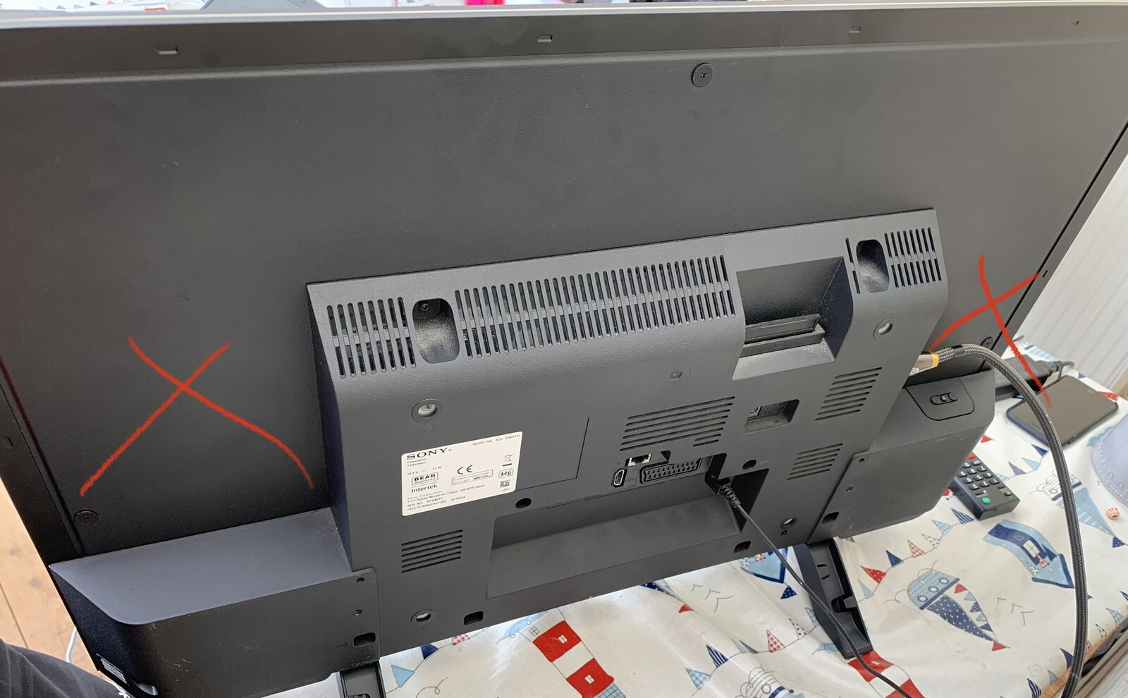

I am planning to mount TV on the wall in kitchen/diner.
The wall is outside brick, and I plan to raggle the wall and fit in trunkin big enough to feed 1 x power cable and 1 x hdmi 1 x cat6 down it.
Top and bottom will be a single pattress box for the cable entry/exit.
My question is where do I have the cables coming out behind the TV? I've attached a photo of the rear of the TV and marked red X where I think would be best area behind the TV.
Thoughts?
I previously used D line trunking surface run which was fine but since the walls are getting plastered thought best to raggle in some trunkin.

i would have the cables exit the wall in the area of the left hand x in the pic and then route the cables over the top of the centre to the connections on the other side. if you use stick on cable tie bases you can keep the route across the top of the centre bulge tidy and the cables wont sag down and show
Thanks @Sureitsoff? great advice, never thought of that way to take the cables, will bring the cables out on the left side.

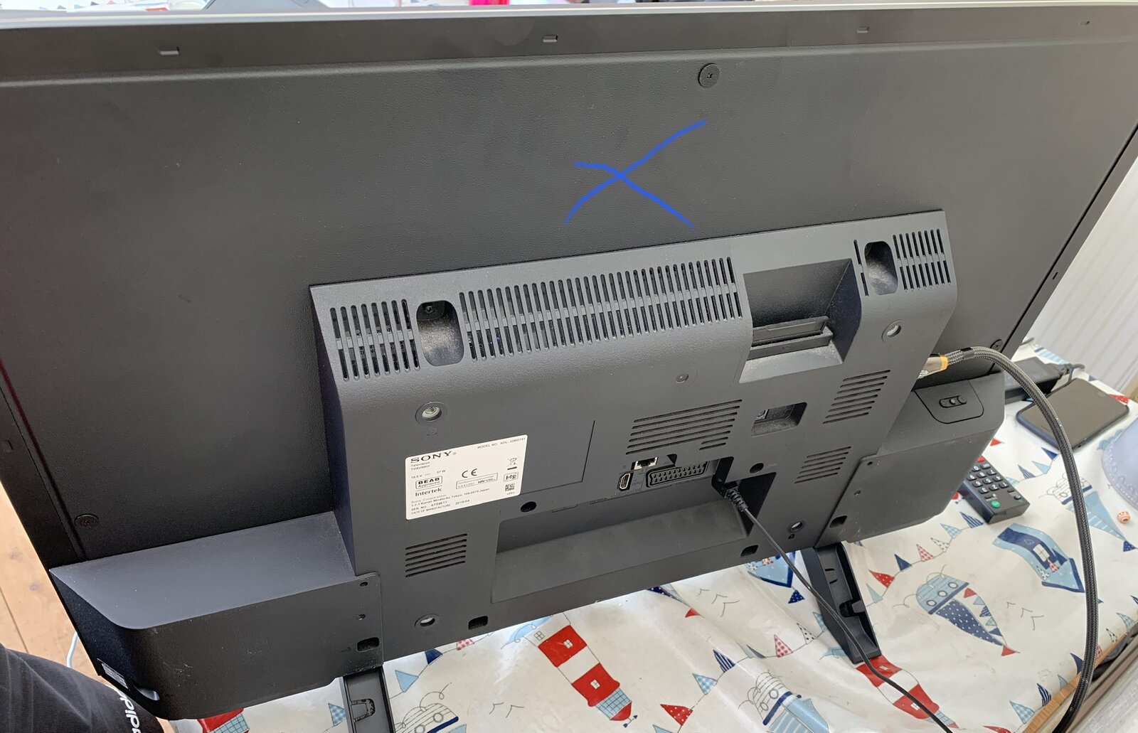

Other option I guess is in the middle, above the bit that sticks out towards top of TV blue X. Above option tho prob gives more room for error or play.
I had originally though to bring them out at the bottom of the TV in the middle as thats how it was done last time with the surface D line trunkin but wasnt until I was look at the back of the TV that space where the X is seemed the most logical space for room.

Above and centre line of the bracket. Tye TV should be on a bracket with a bit of tilt anyway, so there'll be more space above the bracket compared to anywhere else.
Don't bother with socket face plates. Bury a backbox as normal, but use a brush plate to finish off. Leave enough speared cable to reach a foot or so past your present TVs socket positions. This spare cable hides in the wall or under the floor. Doing it this way means the signal cables are always the right length since you just pull out what's needed.
