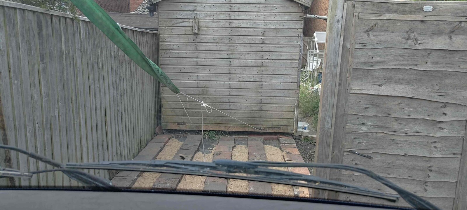

Hi,
I have to move a 10X8 ft solid built shed approx 30ft down a garden.
I intend to lay scaffold planks as tracks and drag it.
Any idea how much force is needed. Would a large van pull it, without burning out the clutch, or do I need a pulley system?
Cheers, C
Several years ago, but I needed to rotate our 12 x 8 shed around, complete with floor. I jacked it up all round, a bit at a time, set it on bricks, then scaff poles, then got the help of friends to lift it, via the poles, and turn it around.
In your case, if the floor joists run in the direction you want it to go - hoist it onto scaff poles as rollers, sat on planks. Then a track of planks laid when needed up the garden. attach a series of ropes likes a series of V's, so all the joists get an even pull on them. I would not attempt to pull it with a vehicle - it will wreck the clutch. Use a pulley system, maybe attached to the vehicle.
If the joists go the wrong way, then you will need to had several planks bolted to the joists. Attachment holes drilled in the planks, then ropes in a V to pull on.
Wait, until the ground becomes hard and dry too.

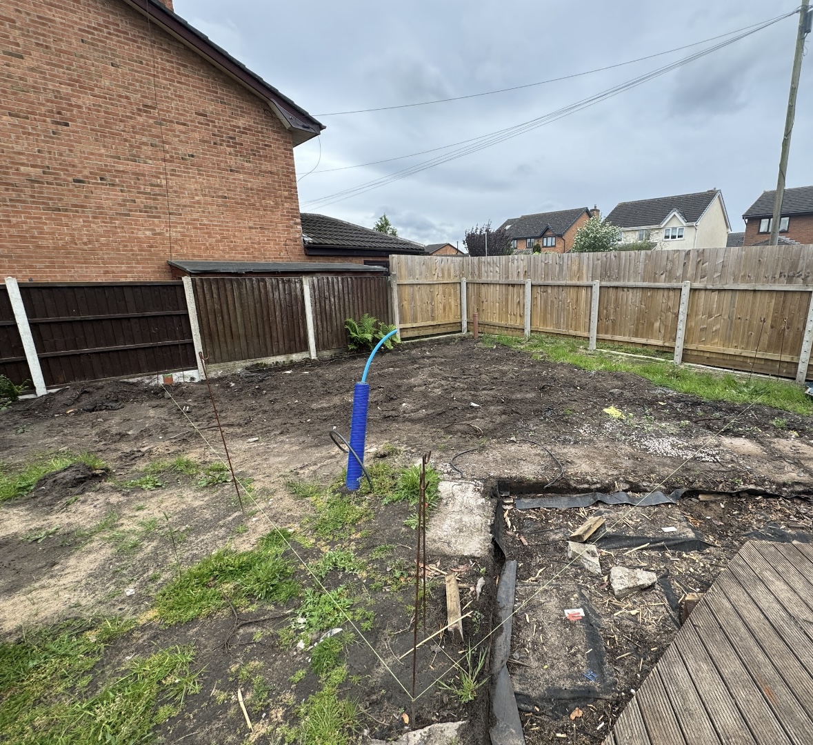

Next job was to clear the space for the outbuilding which mean the moving the shed, removing a conifer tree and then removing the old fencing.

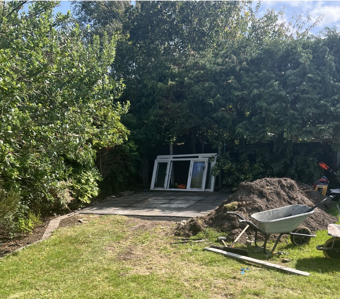

Using leftover hardcore, sand and paving slabs from the old driveway I’d replace, I relatively quickly knocked up a new shed base patio - didn’t need to be pretty obviously as it was going under the shed.
(The old uPVC windows are part of my stash of building supplies).

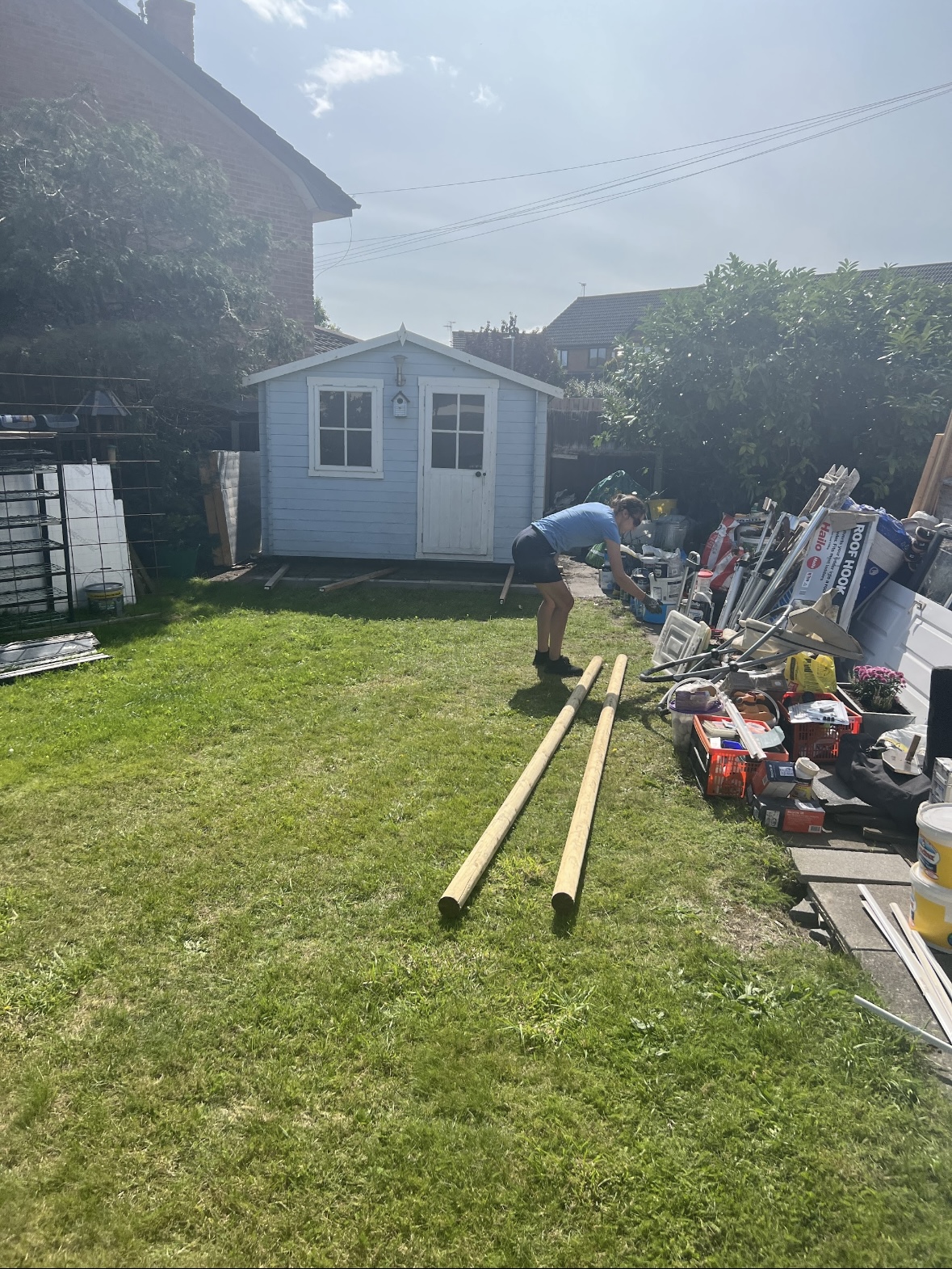

Then came the fun part - the shed move!
The plan was to use the stone henge method to get the shed 15ish metres and turned 90 degrees for its new base.
Step 1 - pick a nice day and empty all your crap from the shed.

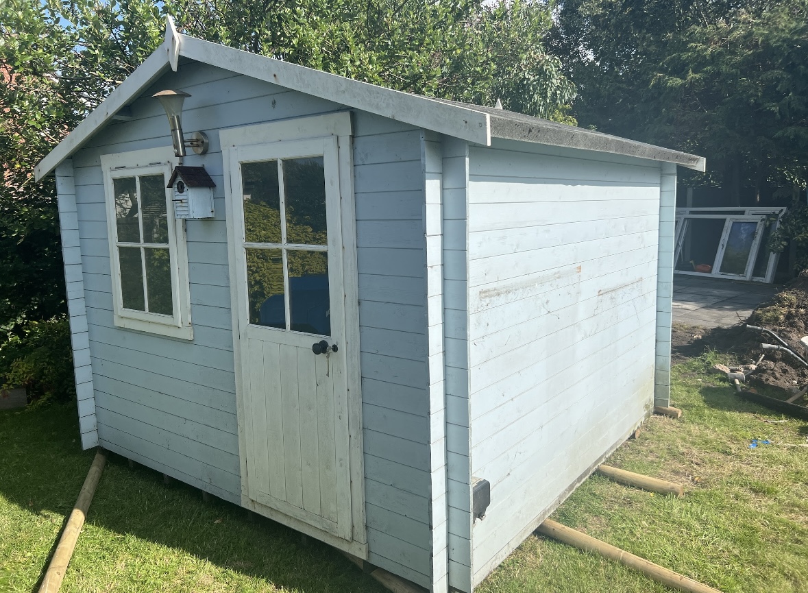

You can see in the picture the 3.6m 3x2 inch lengths of timber already inserted under the shed to lift the shed using the power of leverage. Also in shot are a couple of the 3.6m 4inch round fence poles I bought to do the main work of shifting the shed. I had to search quite far and wide to find those at a sensible price!

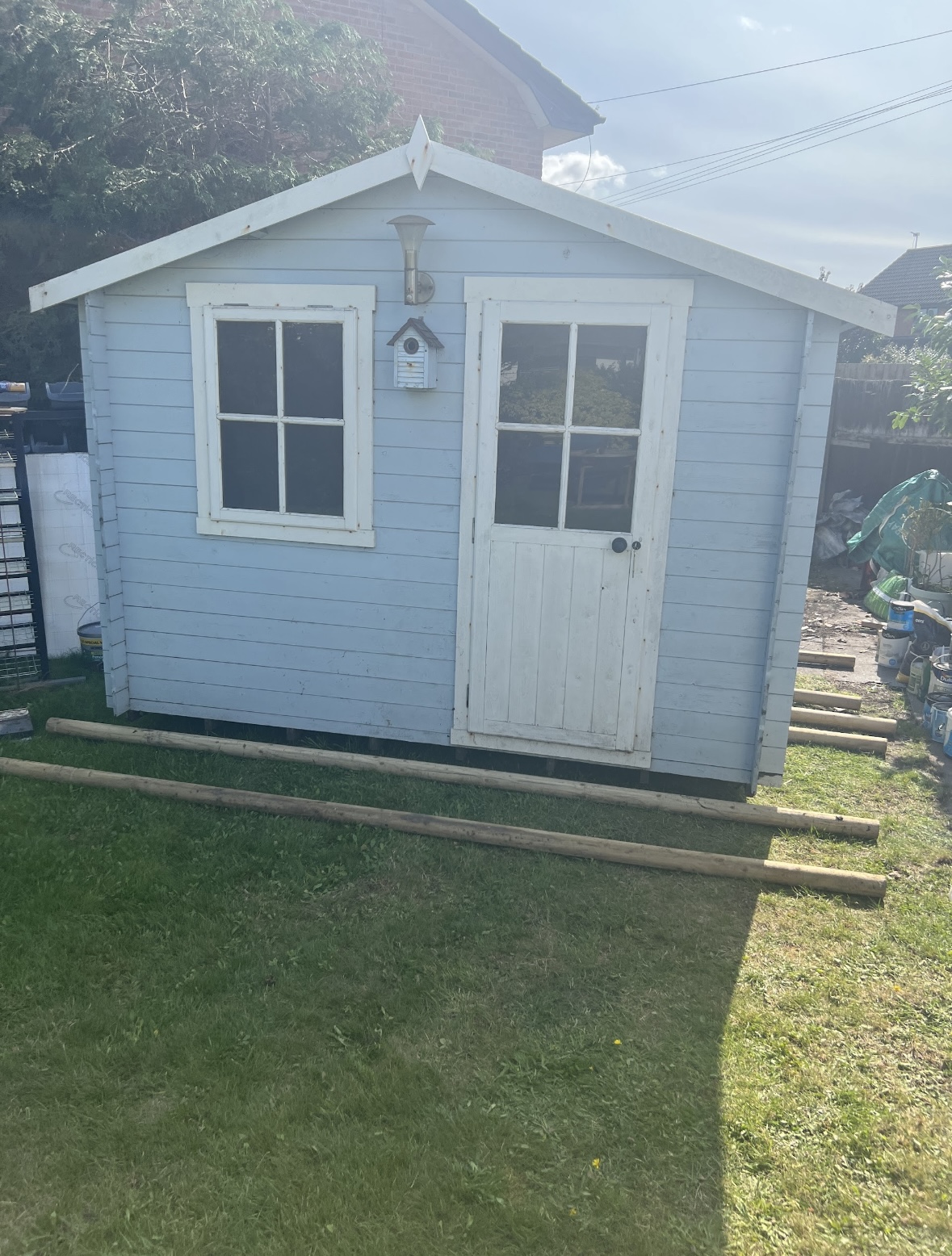

Step 2 - get it rolling.
It certainly helped that I knew the shed had a decent floor supported by 3x2 timbers (from when I built it). The worst part was the initial lift to get the fence poles under the shed, as I had to try and lift the shed evenly while Clare inserted the first poles. In the end I used two of the flat timbers, one under each shoulder, and from a crouched position I basically stood up and with a bit of creaking (from both my knees and the shed) it lifted up at the front.
Once the first couple of poles were in, I repositioned closer to the shed and repeated. When we had 4 poles in, the shed lifted its own rear up and I could get behind it and simply push (although it was still ruddy heavy).

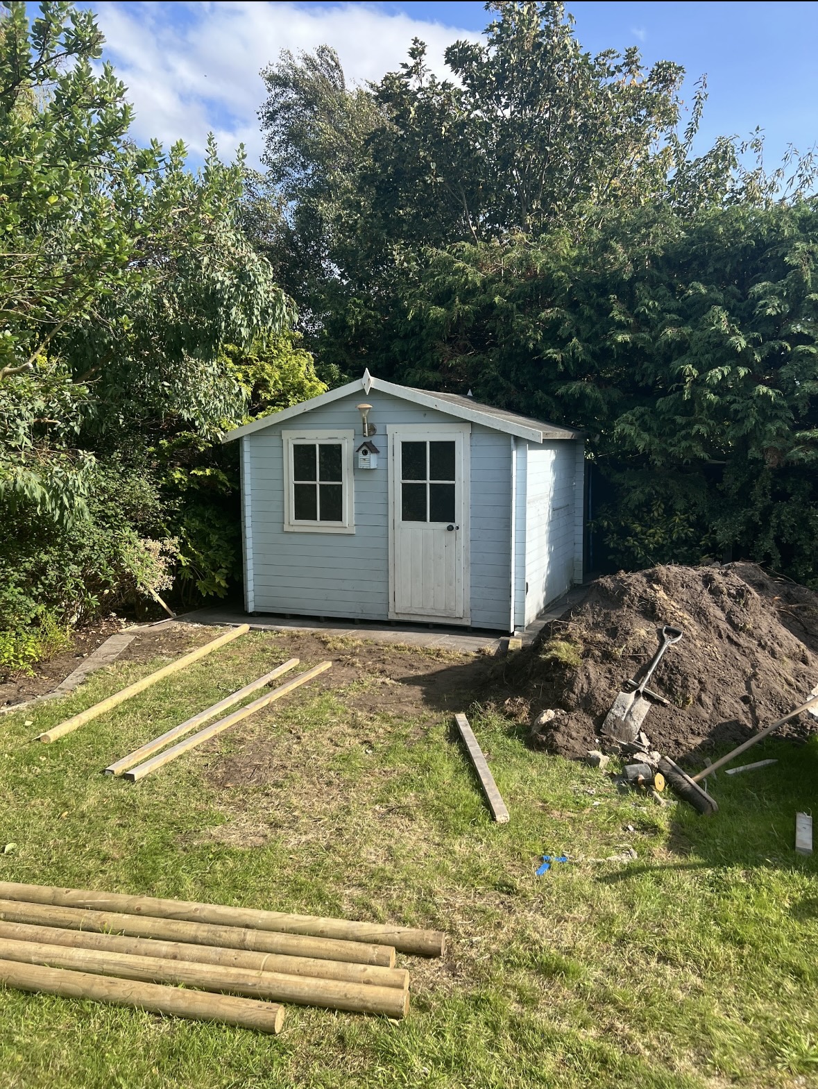

Clare would remove the poles from the rear as the shed went forward, and replace them at the front. Slow going but we then had to pivot which was fiddly and we could have done with a few more poles.
And hey presto, shed in its new home after a bit more leveraging to get the poles out from under it.

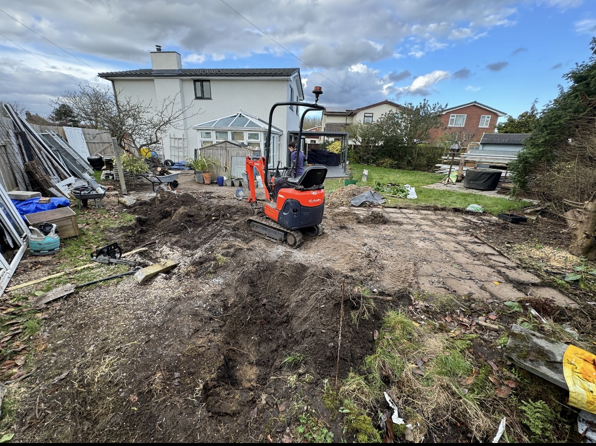

I could then crack on with removing the old patio where the shed had been (the flags will get reused around the new garage. I then had to remove some old concrete fence posts that seemingly had half a ton of concrete holding them in place.
Thankfully having a mini digger at your disposal makes these types of jobs easier!

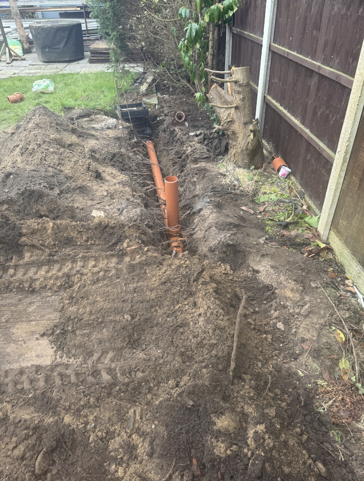

Then I put in the drains in for the rainwater (linked to the pre-dug soak way). In hindsight I should have removed the conifer stump which was massive before putting the pipes in, which made it more fiddly, but again having the digger to pull the top of the stump helped with pulling the rest of the roots out.
Finally, once again after all the work, you’re back to bare ground and nothing much to visually see :D
Not that you can see it in the photo, but I’ve pegged out the outline of the garage with sting line below too.

Hi,
I finally got round to it. 10X7 not 10X8
As the joists are in line with travel, I just drilled holes in the centre three, pulled cord through the holes, and dragged it, using scaffold planks as skids. I used the van roof rack, so it lifted it as well as pulled it, and it's now where nature intended.
Thanks for all of the suggestions.
