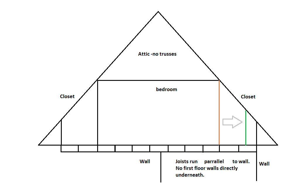

I am wondering if I can relocate a wall farther under the slope of second story roof. The closet wall runs the length of the rooms on the right side of the house (early 1900s). I attached a diagram. The wall would be moved about 2.0 ft. to allow for more room. There is no first story wall directly underneath so I doubt it's load bearing. However, I am wondering if it is important to the roof structure. Thanks!
You need a joiner or builder on site to give a safe view on what you propose. There's sometimes more than meets the eye in such simple seeming alterations.
