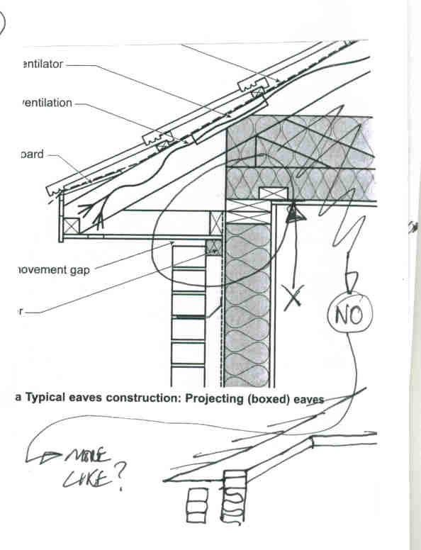

Big thanks all for more comments – some good stuff for me to think about :) , plus I couldn’t help notice the entertaining diversion !! I’ll see if I can’t try and sketch out some more detail of how the ceiling joists and other joists might look/tie together for more comments from the pros here. That could take me a while seeing as how I’m still trying to work it out..
I didn’t say before but it does say in my plan to ‘build ends of the hips into the existing wall’ – I’m guessing I chisel out some slots and then how am I ‘fixing it into’ existing wall? Should I also extend top wall plate and birdsmouth it onto same as well don't think so not sure?
Another query please :!: – I’ve been looking for how to connect the rafters to the timber frame headbinder where the sloping ceilings will meet same at the 3 exterior walls. I have seen plenty details in books etc. how it is done for the more ‘normal trussed ceiling’ (which has a horizontal rafter within the truss as well at this point as per attached diagram) but not for my type. I’m believing for my sloping ceiling I would use angled truss clips but would like to see a picture or some confirmation as I’m finding it curious I cant seem to find this detail in books/internet etc. (My plans show some detail of how to join to a lengthy RSJ over back sliding doors with truss clip but I am wanting to see an example for rafters meeting headbinder where no RSJ like new end walls) Sorry if I make it sound confusing. Again thanks in advance for any comments!!

Your rafter will be birdbeaked over the plate as per normal; a couple of nails into the plate will suffice, you don't need any clips.
If you build the hips into the wall, that's ok. Make a slot, form a birdsmouth on the hip rafter and slip it into position. The main thing is that it must be birdmouthed on the wall support and over the plate.

An inclined member, be it a rafter or hip will always want to move outwards at the lower end, if both ends do not have a horizontal seat onto their support; the same is also true where the member is birdsmouthed only over the wallplate, but not at its top end. Ceiling joists usually do the job of tying the foot back, but you've only got these at high level, so they won't be doing anything useful in this regard.

This ‘building into wall’ - might it be a case of a) using a grinder and chisel to carefully cut out as least brick as possible, put the hip end in and cement back in some carefully contoured bricks around the hip end. or b) is there a bit more to it than that like inserting some form of angled metal wall hanger as well into the opening to nail hip end onto as well, as well as birdmouthing onto a wall plate below. Perhaps don’t need it to birdsmouth onto a wall plate at all but just birdsmouth into wall?
Also when noseall said “uppermost” part of the hip blade I’m thinking once I put the end into the wall I will have ended up rebuilding all around it so am I missing something
Thanks again
there are more economical and sturdier ways of restraining a hip blade than building it into the masonry. i find building it in mildly amusing. when the timber shrinks you will be able to pull it out if you wanted to. :rolleyes:
it would make more sense to bolt something below the hip to the wall then mechanically connect the hip to this.
