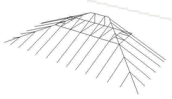

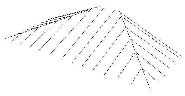

The first attached line sketch “top rafters” shows the general idea of the ‘top’ roof rafters.
My extension has a slanted ceiling section and then it goes flat higher up. I am lacking detail of what rafters to put in to create this flat roof section within my plans which could have had more detail.

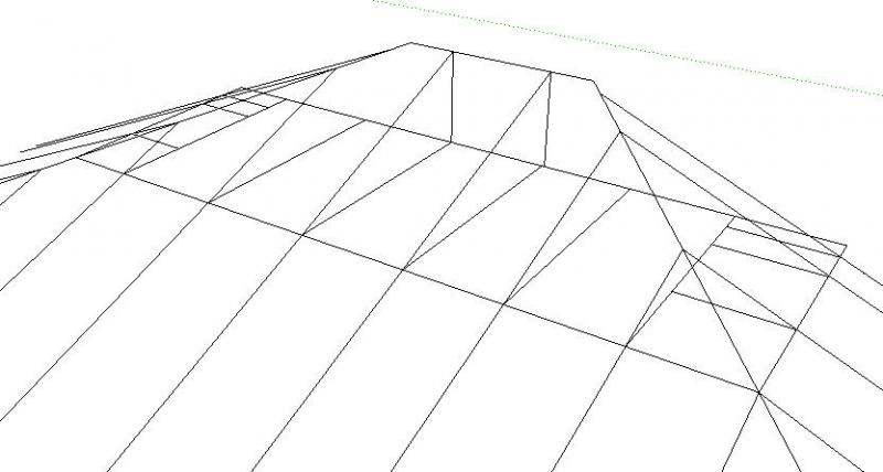

The next drawing shows my thoughts as to what “under” rafters I could put in and the last drawing shows a closeup of what rafters to put in. I’m thinking a short upper wall plate which takes the hips and two rafters and a longer bottom wall plate which takes a number of horizontal rafters which both brace? and give me something to screw the flat ceiling onto.
I’m after some guidance/ opinion please on my thoughts on my proposed ‘under rafter’ arrangement ? – (I’m thinking I need all of this to brace everything up but what do I know..)
