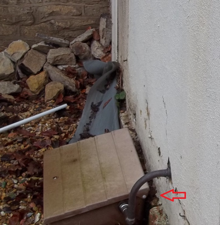

[Black gas pipe comes up from below patio]

Tony, I think the picture shows ot fitted properly to the ground level.
My previous post was intended to show a possible figure of £1000, since corrected.
The picture is of a meter box not finally fitted as there is no outlet pipe connected.
It looks as if there is a concrete slab to be added which will result in the meter box being visually lower.
Tony

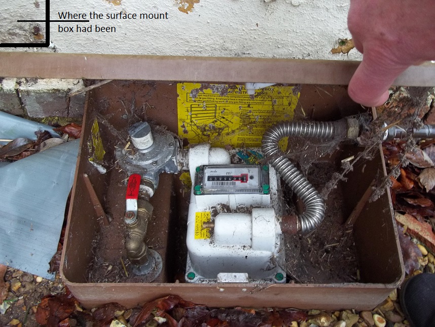

These are photos of my semi con box and shows where the bottom corner of the previous surface mounted box had been.
