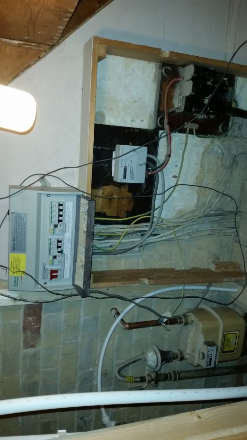

Moving Gas meter. Alternatives
I have attached a Pic. The ECV can remain in the original possition however the meter once the bathroom is made it will be in a "different" cupboard and i have been told it may need another ECV. As you see there is space enough, the plan is to move it under the RCD box. Since i have the choice of getting a smart meter for free this should make things easier. Does smart meters HAVE to be installed by SGN as well?
If you'd approached me as a customer North I would have no problem doing what you've asked after I'd explained some of what has been mentioned above, from what you've posted it seems a fairly straight forward job.
Smart metres? Don't get me started on them!! Suffice to say I will NEVER have one fitted in my house.
They'll more than likely put the metre in the same place, fitting a secondary ECV would be straight forward if needed.
North you always need access to the primary ecv, and enough room to change it.
Your best bet is to have the whole moved outside.
See how much they would charge you for this
