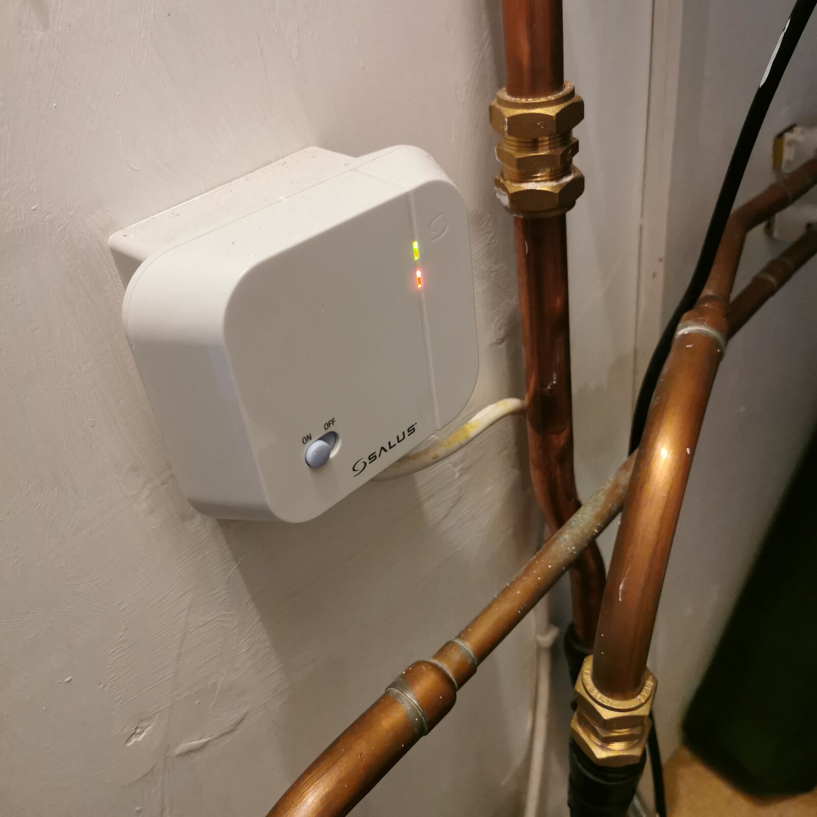

Hi, I have a Vaillant ecoFIT pure boiler running my central heating and feeding a hot water tank The boiler is controlled by a Horstmann H27XL and a salus wireless thermostat controlling my tower central heating pump. Can I swap out the Horstmann and salus for a Hive or similar? Just looking at the current savings to be had and wondered how difficult it would be? I'm happy with working with electrics. Any help appreciated. Cheers.

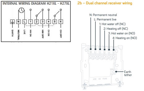

Yes, you can. The Hive [you need the Dual Channel Version] would directly replace the Horstmann. The existing wires are simply moved from the terminals of the Horstmann to the Hive terminals that have exactly the same function.....
.....So based on the above diagrams, the wires in:
N = N
L = L
HW off (3) = Hot Water off (1) (This may, or may not have a wire in depending upon your plumbing arrangement)
HW on (1) = Hot Water on (3)
CH on (4) = Heating on (4)
The links at the Horstmann shown as dotted lines in the above diagram are discarded, the Hive dual channel version has these already made internally.
The wireless thermostat will go, but it can't just be disconnected, simply removing it would leave the heating wiring 'open circuit' and so it wouldn't work. The wiring to the Salus receiver would need a small modification to complete the circuit. When you get to this, if you post a photo of the wires connected to the Salus receiver someone will be able to assist.
Whilst this applies to Hive which you mentioned, the same principle applies for other manufacturers.

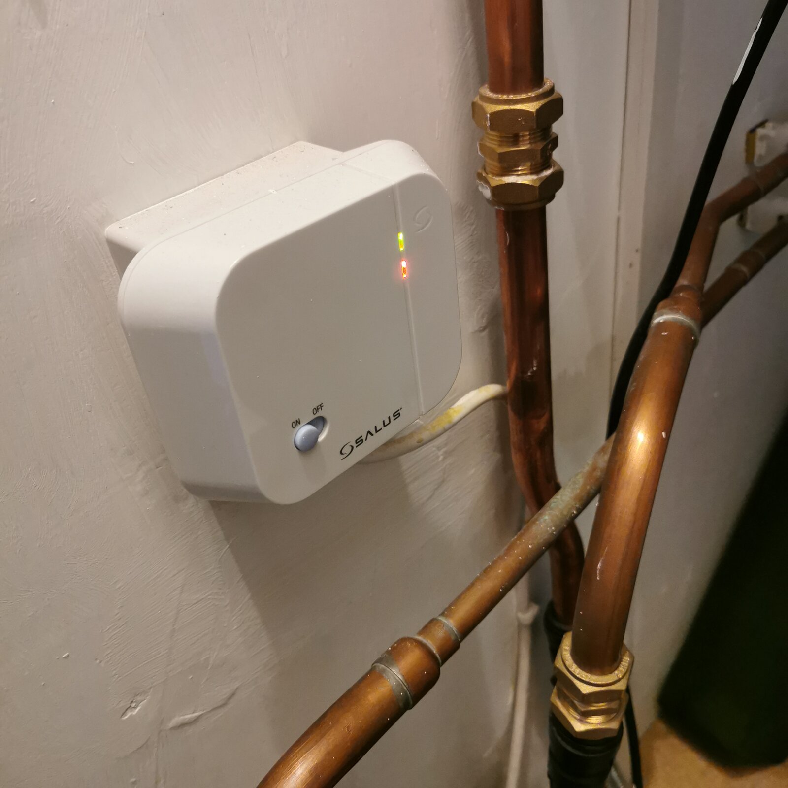

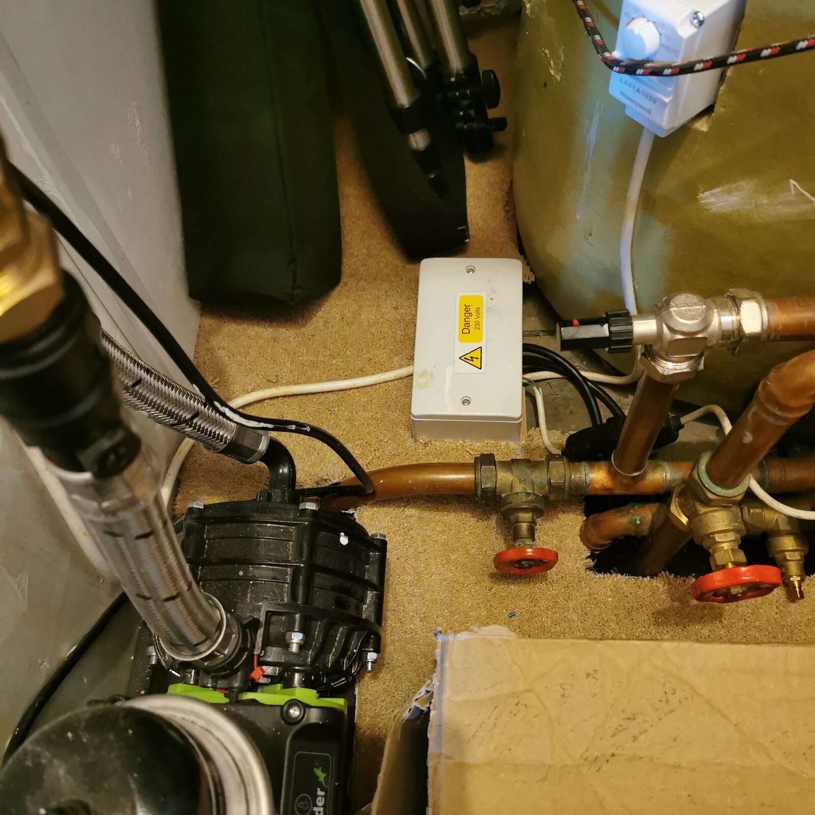

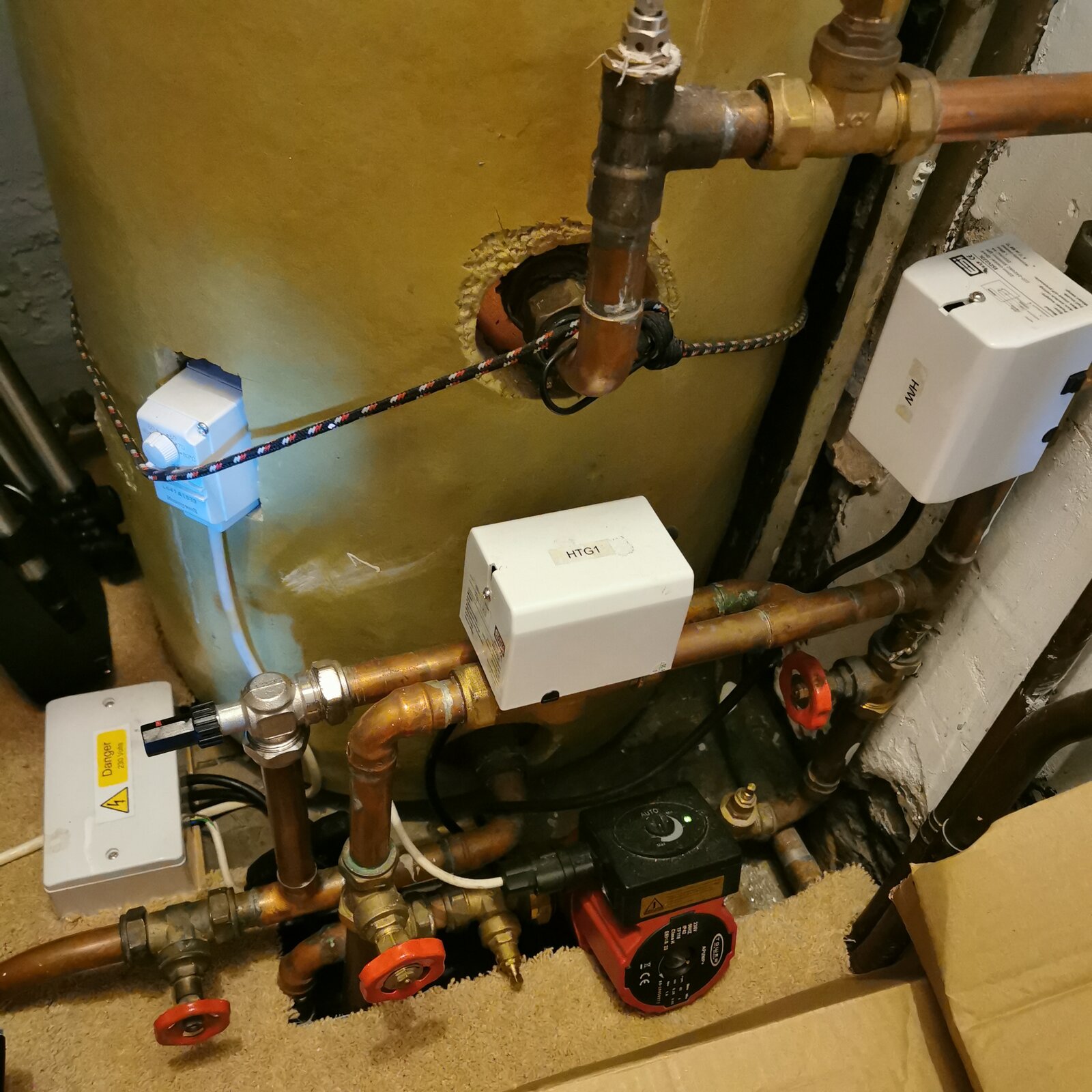

Many thanks for this response. You are most likely right re the motorised valve. The salus is connected to a junction box, which seems to control a couple of valves and possibly the pump? See photos.
no the valve or boiler controls the pump , you have an S plan bungee cord + system :rolleyes:
These are motorised valves.
The room and hot water cylinder thermostats will open and close the valves, and it's then the valves that control the boiler and pump. Anyway the original description of how to change the controls is OK for what you have.
Sorry for what is probably going to be a stupid question, but if the Solus goes, what acts as the room thermostat? I presume the hive will be situated where the Horstmann is currently, as in under the boiler.
Most of my radiators do not have thermostatic valves. I would have thought that I would need to replace the Solus with a hive version of a wireless thermostat?
