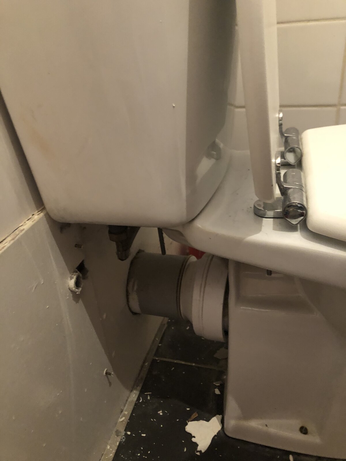

Hi all.
I need to move our toilet out from the wall a few cm because we’re panelling behind it. The waste pipe comes out from the wall behind it and was just wondering - is there’s generally any give in the pipe or if we need to get a new one with an extra few cm on it?
Sorry if it’s a daft question but we’ve only got one bathroom so have to get it all planned out in advance so it’s not out of action too long

Dunno about a few cm but can you move it really depends on the piping there. Do you have a photo from each side.

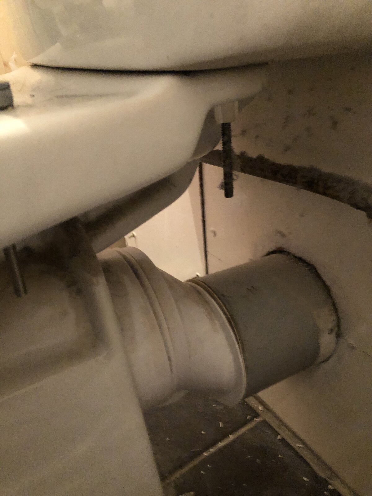

Here are some pics from either side just pumps, it’s a bit dusty back there :-/

Cistern feed pipe looks like solid copper so that probably will need looking at and the donut seal between cistern and pan looking a bit rusty so a new joint required there.
Could you leave pan in place until the last moment and use a bucket of water to flush the pan?
Ah that’s a great idea, I can probably get most of it done with just the cistern removed - hadn’t thought of that. Never even heard of a donut seal so thanks for the pointer on that too. This is a learning experience
You can buy a plastic collar to cover up the hole where the 4" pipe goes through the wall. I`ll try and find the link to one later unless someone else can.
I left our toilet base in and used bucket as a flush.
We were in same boat, only 1 toilet!. Was a busy couple of hours after I'd smashed the old one out, luckily all went to plan.
