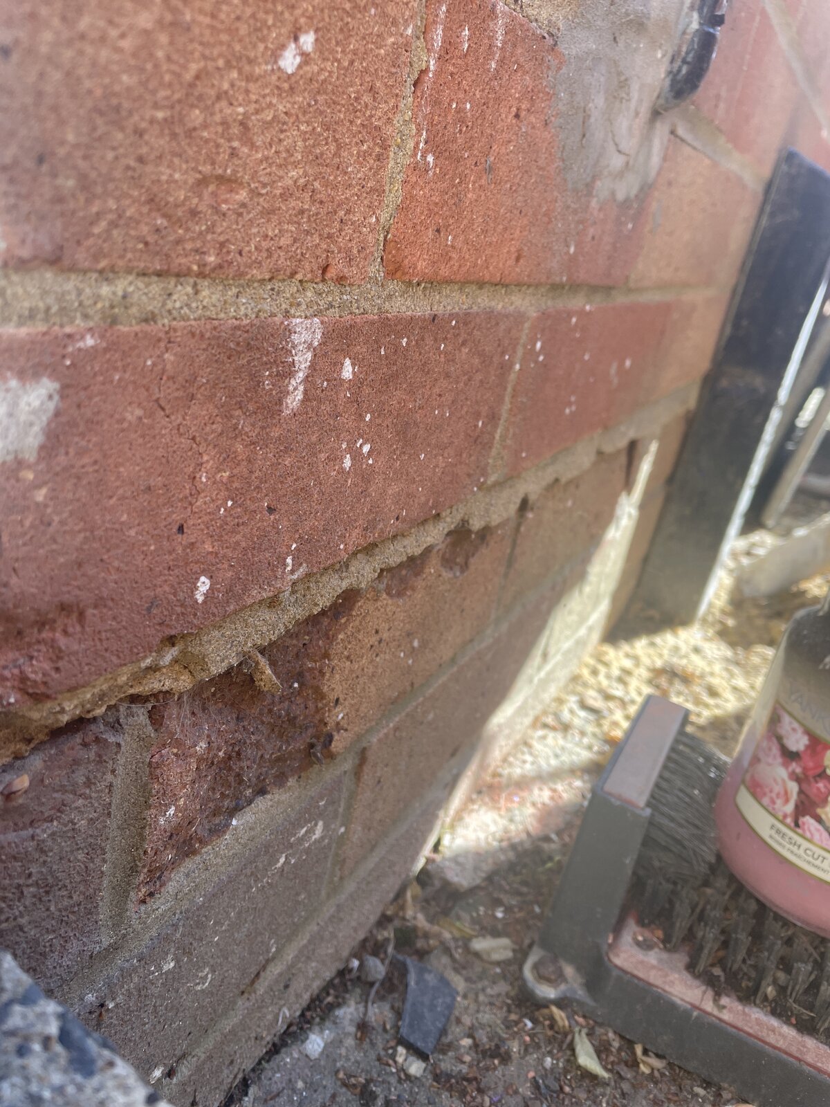

Hi my property is 1970s and has signs of movement a small vertical crack below front window a small diagonal crack from the soffit to the top bedroom window and most concerning along the side of the house about two metres long it seems the brickwork has slipped of the dpc course 10mm at its worst point I will upload a pic. We are on clay ground I did find that the waste pipe from the dishwasher washing machine and kitchen sink was broken and allowing water into the ground and have since replaced. Could that be the cause of the issue and is this an exspensive repair?

slipped? more like built that way when they realised they were way out.
check the other houses in the street , there’s probably quite a few the same.

The elevation has expanded on the DPC and moved outward. Its common, and not normally progressive, and not repairable other than repointing.
