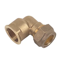

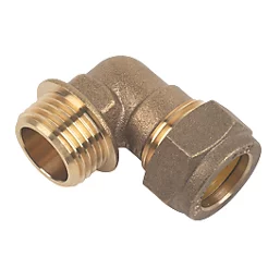

Oh I see so keep the upstand pipe there but move the tap itself? would you have anywhere to attach one of these onto, to support the tap and any pipe?
@Madrab Exactly right - just moving the tap sort of speak.
Definitely a few spots to either 1.5m left/right and I can affix the fixture onto a timber fencing post (plenty of support).
Well if the tap is live, then any sort of undoing will result in a flood. Somewhere there will be a stopcock. You just need to find out...ultimately it may be the one in the road.
Once the tap is dry, then you can dig down, find the joint and move the tap. It's a fairly simple job.
The only constraint you'll have is the elbow that the tap is in just now as that is soldered so can't move so would need to head left or right out of that with the 2nd pic fitting with some PTFE tape
