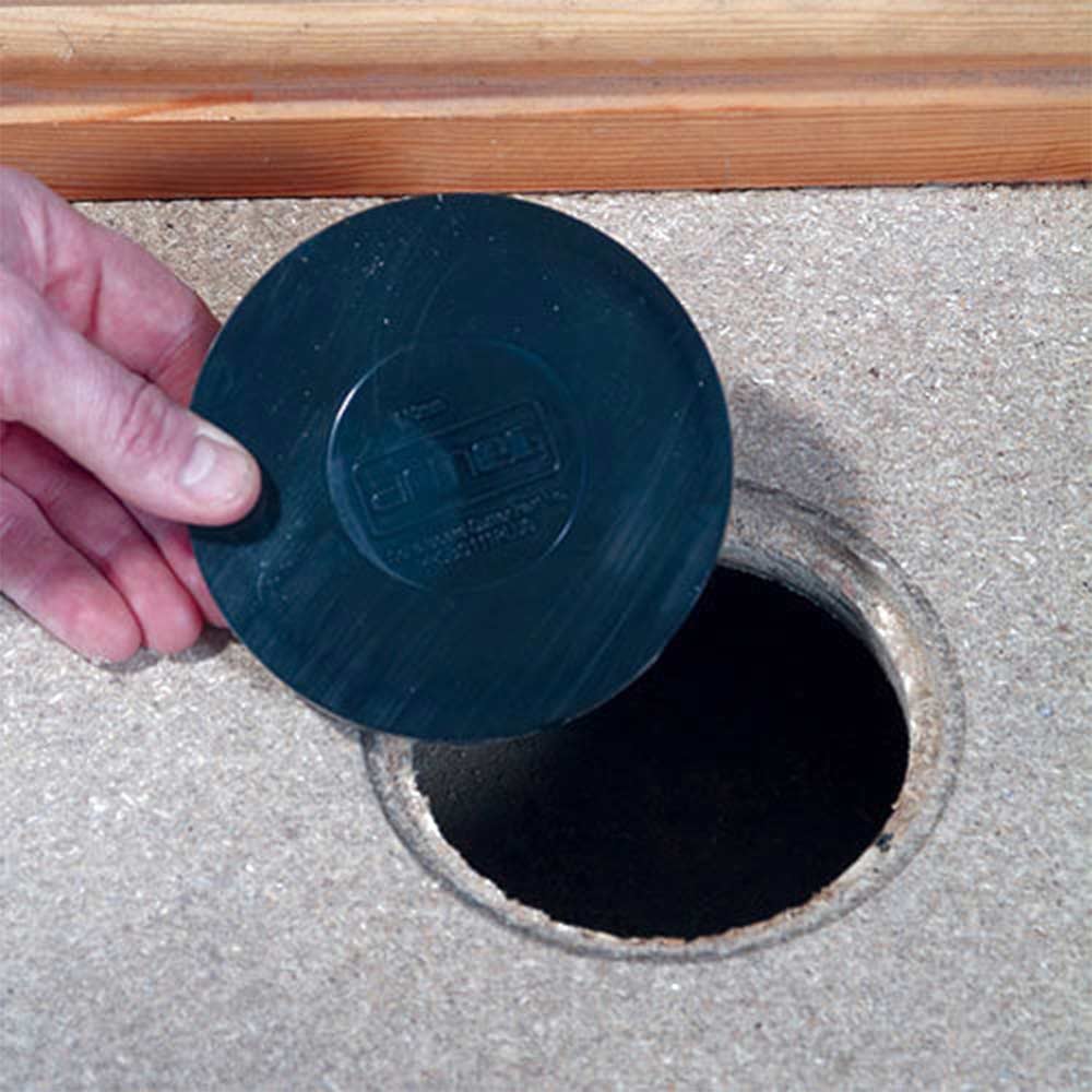

So my conclusion now is that I should work from above rather than struggle from below and risk potential death by asbestos and rather than buy a hole cutter, I should use the multi-tool that I currently have borrowed from a friend or my circular saw set to the correct depth.
Thanks!

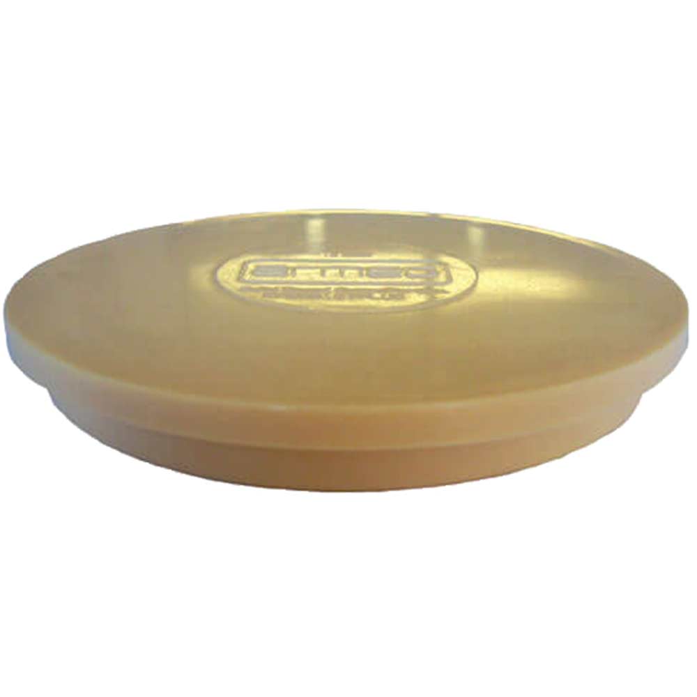

The advantage of using a proper access hole cutter together with the plastic inserts is that the 'lid' fits back in the hole and self-supports. If you do it any other way you will have to insert noggins under the hole to support the lid and then fill in the gap.
The great benefit of the SBC is that it cuts a lipped hole, and you buy matching inserts which just plop into place. With anything else you'll be messing about fitting battens to support the bit you put back.
If I had chipboard floors I'd buy one as a matter of course.
