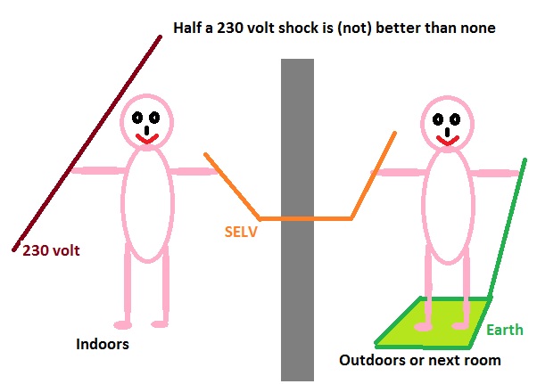

with SELV there should never be an earth connected to either leg
The only reason for not earthing an ELV circuit is to prevent making a path for current to ground when someone is holding a bare ELV conductor in one hand and a mains voltage item in the other hand.
With SELV him indoors is safe until him outdoors touches the SELV wiring. ( OK it is a bit extreme but most accidents involve something at or beyond the extreme )
