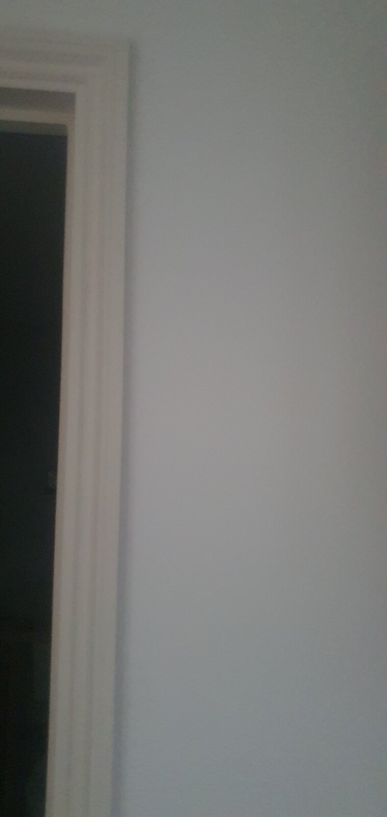

Hello all.
This is my first post so here goes.
My flat has a bathroom pull switch mounted on a concrete ceiling? (solid ceiling) and I would like to remove the pull switch and extend the wire roughly 3.5 feet to the wall (plasterboard) outside the bathroom door where I would use a single plasterboard back box and a normal rocker switch matching the rest of my light switches.

The distance between the existing pull switch and intended location is about 3.5 feet.

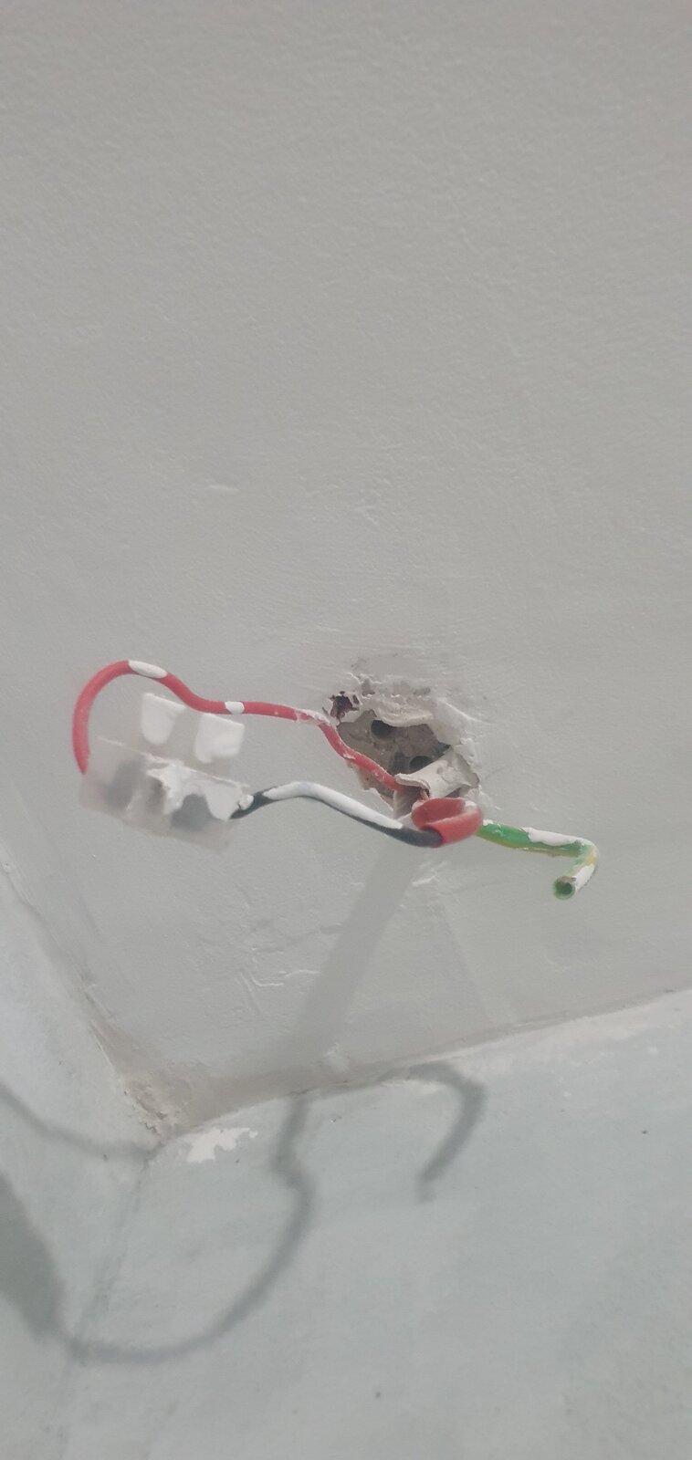

Is the existing switch cable in a tube, running to the light?
I ask this because joining onto the old cable is not ideal, and it would be a better job if there was a continuous new cable from the light to the new switch position.

No, I don't think the cable is in a conduit. At least 6 inches is flat against the concrete ceiling. I was unwilling to pull more away.
If I could solder and heat shrink a section of 3.5 feet cable to the existing then it would be ideal.

If you ran the cable to the wall, and straight down to a switch on the wall, how far would it be from the bath/shower?
5 feet from the intended switch position to the edge of the bath.

It's for the light.
The cable is buried in the plaster, and it's not in conduit.
The current pull switch operates the main ceiling light in the bathroom.
When I removed the pull switch roughly 3 inches of cable came out of the plaster. I was surprised by this. I can only imagine part or all of the cable is buried in plaster. My guess is during the build the electrician placed the switch on the current hinged side of the door and rather than re drill concrete just buried it in plaster to the correct side of the door. The cable is not surface mounted.

It's unusual (but not uncommon) for the cable not to be in round conduit.
Have a look behind the bathroom light fitting, and see if there is a round box embedded in the ceiling, with conduits coming out of it.
I'm only suggesting this because of your theory that the pull switch may have one been planned to go on the hinged side of the door.
