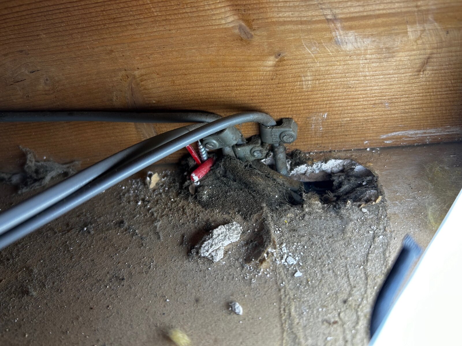

I have three cables dropping down through the ceiling. See below.

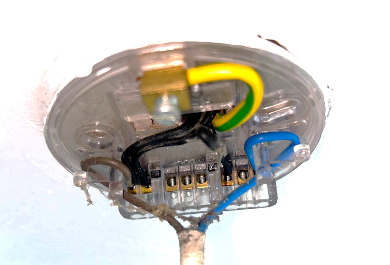

I have two live twisted together, neutral and earth wired into my ceiling rose. See Below.
I intended on simply using a length of twin and earth. Using two 2-way inline connectors to individually join the neutral and earth, and for the live, I was going to use a 3-way connector (or wire nut) to join my 3 live cores. Can I safely join these three individual cables to a single length of twin and earth in this way?

I think you have quite correctly assessed the situation: 3 single cables and at least one but possibly 2 or all 3 also include an earth. However I'd make a guess the 2 blacks together in the left terminal are neutral rather than live.
Assuming this is correct, extending that with T&E will only be totals of 2 wires for switched live, 3 wires for neutral and 2, 3, or maximum of 4 wires for earth.
It's not nasty as such, what you have was a very common way of installing lighting circuits and, if what I see on this forum is correct, still used in some areas in recent times.
Mark the ssingle cable securely (Will be obvious if the 2 blacks are twisted together) to avoid problems when reconnecting.
You need to do some testing to establish which are line and which are neutral. And I would strongly suggest that you check out the earth continuity as well.

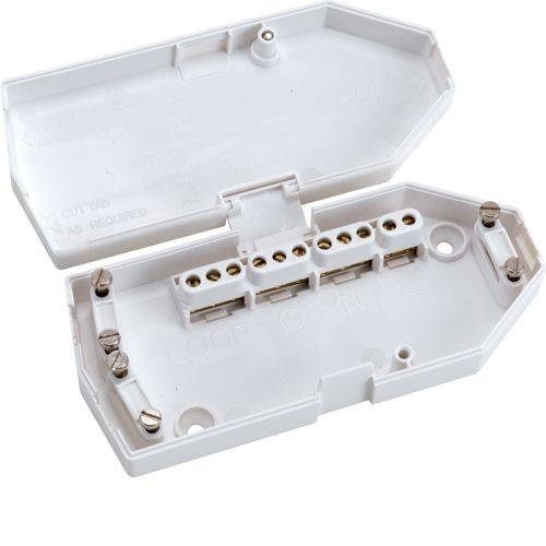

This all seems complicated and too much wire. Wouldn't it be better to put one of these in the loft at the location of the existing rose, and then simply output a single T+E from this to the position of the new rose?

There may be an earth there but is it connected back to the consumer unit? That wiring appears to be late 1960's / early 1970's
It's a 60's house so this particular wiring will be from that time.

I will confirm L and N and then I think the most simple solution would be to use the junction box.

So yes, you are correct. The two cables are actually N and not L. It appears all of my lights are wired this way. My L is actually wired into the N terminal and N is wired into L.
I’ve extended with a junction box but I wasn’t sure whether I should have wired the new T&E up “correctly” ( ie L to L etc ) or “backwards” as it is already.
Thanks.
I would have wired it such that the new cable presents live and neutral on the correct colours.
