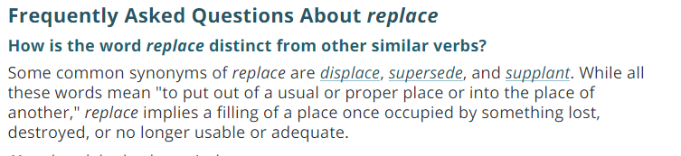

SUNRAY:
Ah. I see now you have not used the actual definitions of replace, but quoted an explanation of synonyms from which replace is distinct.
https://www.merriam-webster.com/thesaurus/replace
... Anyway, no matter what you might find in dictionaries, do you really disagree with me about 'everyday English' ('Common Usage')? If you asked someone to "replace" an extractor fan, tap, boiler, immersion heater, washing machine etc. etc. etc., do you really believe they they would even dream that you were asking for an existing item to be moved to some different location in your house?
I should perhaps have added that the default in legislation is that words have their 'everyday meanings'.
If those who wrote the legislation relating to notification of electric work (in England) had intended something other than the everyday meaning of the word "replacing", they could only have achieved that by including a specific definition of the meaning of that word for the purpose of the legislation - which they did not do.
Kind Regards, John
