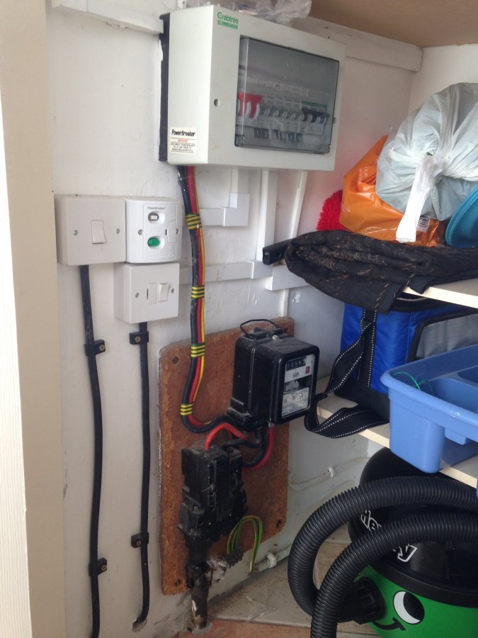

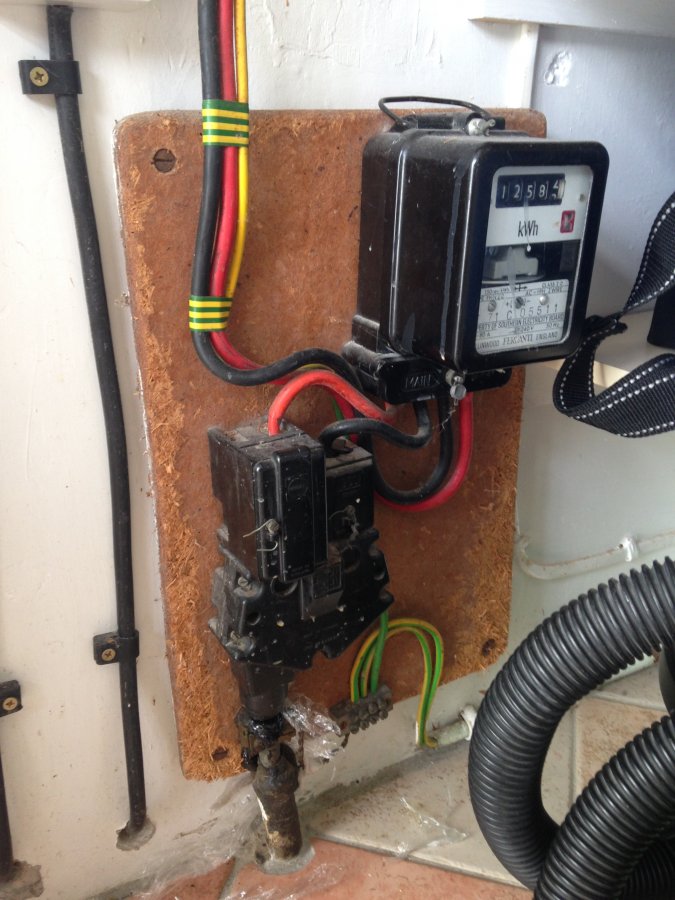

This is our meter and CU in the kitchen. It's going to be in the way when we come to renovate the area (it would end up behind units and inaccessible). Looking to move the meter onto the outside wall in a recessed box. Then move CU further up the wall. I can see the main cable comes in through the concrete floor. Would it be possible for the power guys to flip that cable through the wall at 90deg to connect up to the new meter outside? Or are they going to insist on us finding cable in the pathway to make a new connection?

If the meter is 60 years old ( unlikely ) then the supply cable will be that old and hence with age far too un-flexible to be safely bent or even moved.

As an aside, is that 2x swa cables pushed into those plastic surface boxs as cannot see any sign of gland/shrouds, if so they need taking out and reterminating correctly to ensure safe usage
@yorkspark If you refer to two black cables, they are for outside power to the summerhouse. Everything will be brought up to code when the kitchen is done.

They will, since there are no procedures which involve moving old cables like that. The risk of damage is far to high. It's cut and joint in a new piece, all done live.

The meter is 45 years old, and has probably been refurbished since it was originally manufactured. If you want a new one then contact whoever you buy your electricity from - which is not the same company as you contact for having it moved outside.
