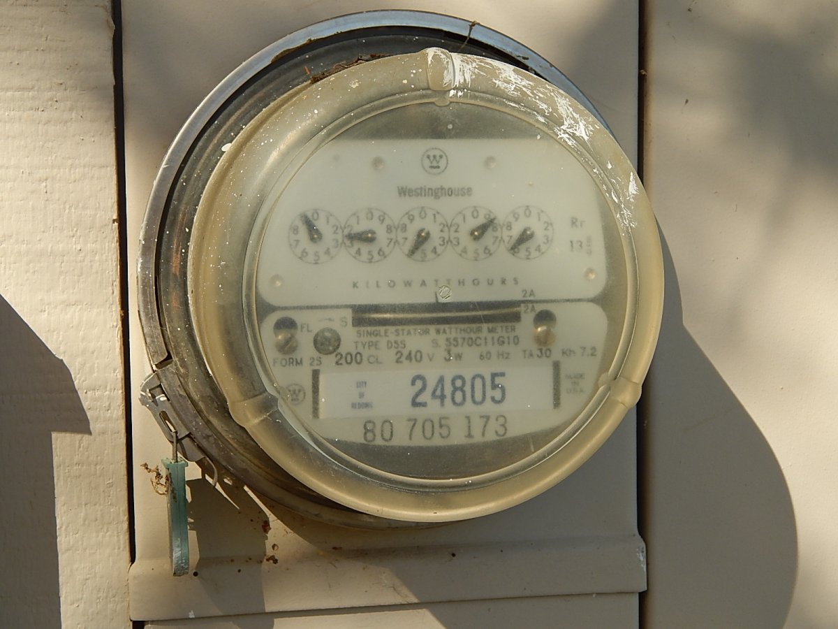

Here in Redding, the city operates its own electric utility and has decided not to adopt the "Smart Meter" at all, so we're avoiding all that nonsense at the moment. We still have a simple electromechanical Westinghouse meter on our house:
