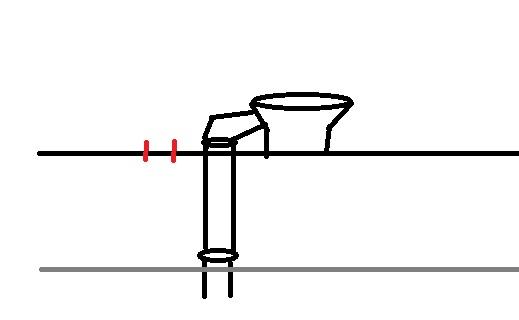

Hopefully not a big problem but I need to move my toilet waste back about 6 inches or so.
It is so far from the wall at the moment that the toilet is half into the room and looks odd. The pipe is iron and comes up between the floor joists.
I assume I will need to cut the iron pipe and put a new connector on it. What sort of connector do I need for this and what do I seal it to the existing pipe with?

I have taken a few floorboards up today to get a look at what I am dealing with. Sadly I can't see what size the pipe is because the sockets are covered in something, but I would estimate at 4".
The pipe drops down below the floor for about 1ft before going into another socket, below which the whole lot is concreted in.
If I pull the pipe apart at the lower socket (whats the best way to do this?) is there a connector I can use here to move the pipe back by 6" or so?
I have attached a highly artistic drawing to give a rough idea of what I mean.
For pipes nearer the horizontal I would use the rubber connector I linked to. For a vertical you can use one of the more easy to obtain ones with the fins on, but they take up what I think will be valuable vertical space.
So its time to measure very carefully to see what can be achieved.

The centre of the pipe is currently 33cm from the wall, we have decided to put a vanity unit behind the toilet so until it arrives I'm not quite sure how far back it needs to go.
Once it arrives I will be back with better measurements.
I think I have had some good luck (although I am going to claim design).
I have had the vanity unit delivered and it is 30cm deep. The toilet is a back to wall type with the waste connector being 10cm back from the back of the toilet. The combined distance from the wall of the porcelain connector at the back of the toilet is 40cm.
The centre of the existing pipe is 33cm from the wall.
What do I need to buy to join this up - I am assuming I don't now need to move the waste in the floor?

See my sketch of your dimensions, the vanity unit is over the drain connection. Can you correct or explain? As it won't work with what you are telling me so far
Yes the front of the vanity unit sits above the floor drain, I had planned to cut a notch out of this for the pipework as it will be hidden by the toilet.

That will be a huge "notch".
A macfit-wc-connector might fit but I'm not sure how far onto the pan the connector will get. You need to search for similar
Got to be easier than pulling the pipe apart tho?
Very true! btw the part I linked to is a McAlpine MAC-8L none of the other connectors they do seemed suitable. The awkward bit is the distance from the pan outlet end to the centre of the drain - 70mm. The seal inside the connector has to overlap the pan outlet. I like McAlpine stuff because I find the quality good and the tech drawings very useful. The connector would I am sure work with a dimension of 60mm so you can see, yours is boarder line for that connector.
