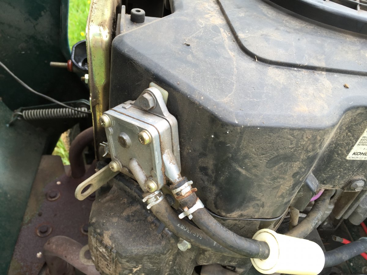

Are these pics any use?
The first pic, with the two pipes, is the fuel pump that works from crankcase pressure pulses to deliver fuel from the tank to the carburettor. The cylindrical white thing is a fuel filter.
The two pipes you see are fuel into, then fuel out of, the pump. The other pipe around the back provides the air pulses from the crankcase.
The lower pic is of the air cleaner inner plate......to access the carb and remove it, you have to remove those two flange nuts, if you want to go ahead. It looks like you have a single choke carburettor, which is the simplest of the carburettors that could be fitted.
If you want to bash on, you'll need an aerosol of carburettor cleaner from a motor factors at the very least - and a compressed air supply is very useful.
John :)
