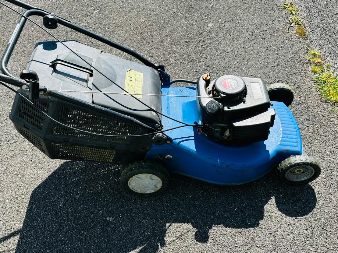

The mower is shown in photos supplied, ignore model number on engine as different engine fitted to deck.
It was self propelled by gearbox died so its only used as a push mower for certain height grass which isn't that often.
The gears inside the wheel have also been removed hence now being a push mower so they are ruled out.
Ive noticed it now veers to the right & when used last week it was fine.

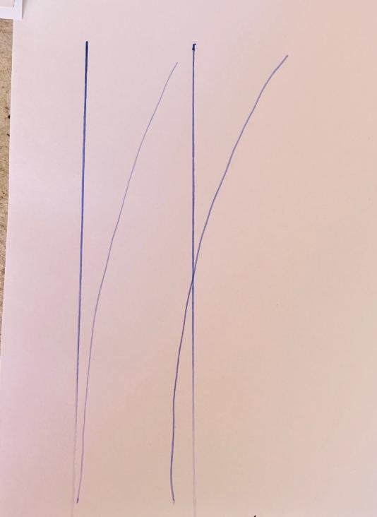

Basic example shown in supplied photo of what it used to do & now what happens.

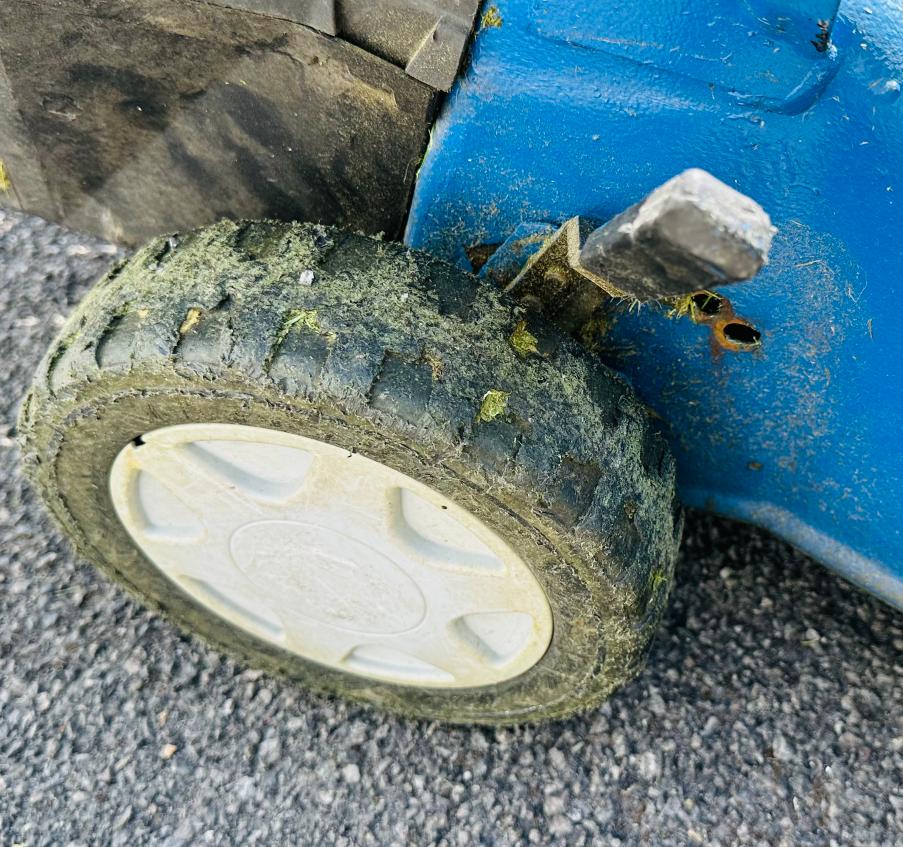

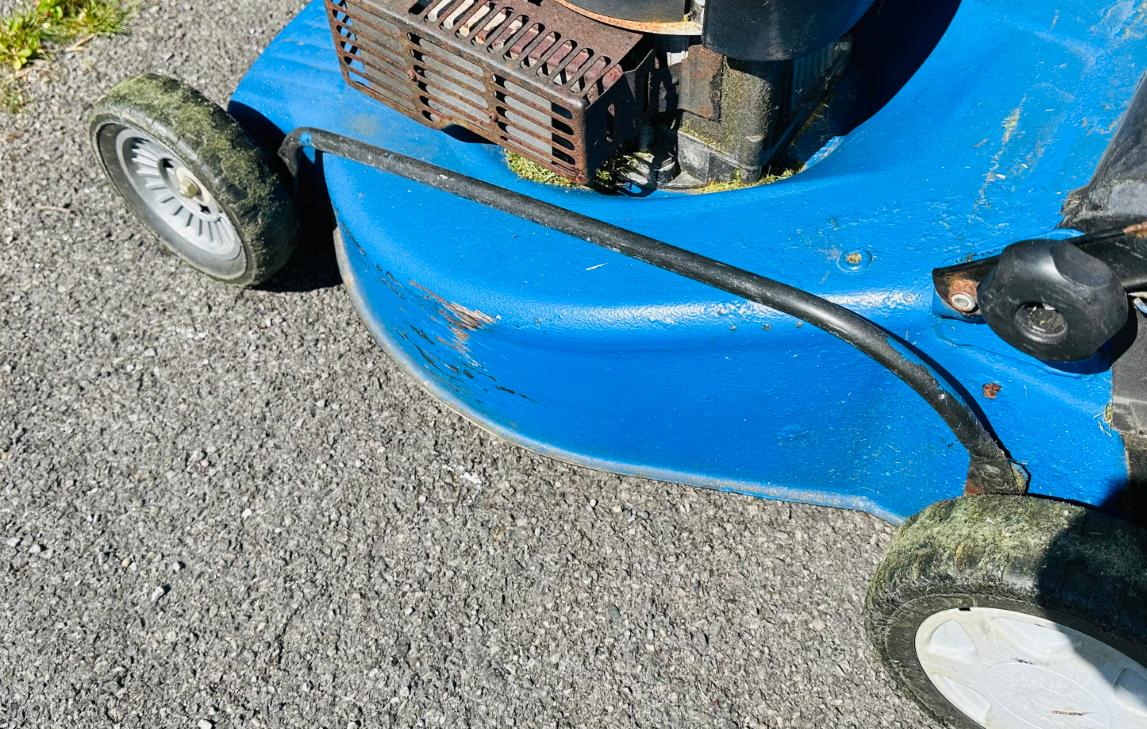

This mower has a lever only on one side at the rear right which then has a bar connected from axle on left side over to front wheels for front height adjustment.
My question is what's caused this to now happen.
Are there certain bushes that wear out & as the height lever is on the right that's why it veers to the right or advise otherwise please.
When mowing this morning im having to use more force on my right hand as opposed my left just to keep it kind of straight.

I'd check that the lever is connected properly to the other wheel and that under pressure it doesn't "slip" into a lower position also check all 4 wheels move freely and any bearings/washers/spacers are present & not worn down
I have removed 1 wheel at a time & cleaned using carb cleaner, then used GT85 spray & re-fitted wheel.
All spun fine before cleaned & also after being cleaned
Lever is fine & i dont see any issue with height of grass when looking back at what i just cut.
The lever is welded to say the axle & other side just moves the same as other side.
In the past ive seen levers slip / drop but this definitely doesn't.
Ive sprayed up all the wheels & there moving parts & none are sized / drag etc & all move freely.

Centre of rear axle shaft through wheel to front axle shaft through wheel is say 670mm & looks to be the same on both sides

I put mower back on floor & within 1 metre pulling it back not only can you see it starting to drift to one side but you can also feel / pulling when holding the handle.
