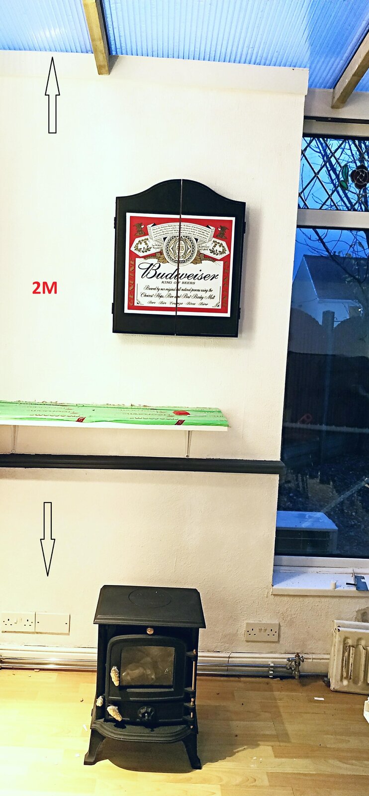

I guess a pic or sketch of your layout may be helpful ?
Here is a photo of where I propose to put the stove, I can confirm the wall is concrete block, plaster boarded over & skimmed. The height from the flue exit on the stove to the roof is approx 2M. Obviously everything will be removed off the wall, including the dado rail + wallpaper if required
Aside from any height issues and supporting it outside, the Power outlets and skirting have to be considered.
Whats within the stove manufacturers distance to combustables to the left of your proposed position.
As well as making allowances for flue manufacurers distance from that roof rafter you have to fit a suitable flashing ,if theres any capping over a sheet joint you may need to move flue to the left of it
Yep, you'll probably need to move those sockets & cut the skirting back, you'll definitely need to fit a heat shield to the wall, and you can't put the flue brackets on the plasterboard as they'll push through it over time - you'll need to cut through to the block. Might be easier to cut a section of plasterboard away floor to ceiling then get it hardwalled instead.

The Manual & plate on the back of the stove state 800mm from the rear & 600mm from the side away from combustible materials, which is obviously too far out from the wall - so I would have to remove the
sockets/skirting board & the plaster board & hard wall it, fit a heat shield & then I could have it closer to the wall? 600mm from the side isn't an issue I don't think.
Removing the sockets, skirting board, paper etc isn't a problem, but I assume I would have to remove the plasterboard aswel?
Can someone advice me on 'hardwall' how is it done & what would be involved - I'd certainly need the help of a tradesman here as I cannot plaster myself
You wouldn't need the heat shield with hardwall. The heat shield is there to protect combustible materials, such as your plasterboard, which has a nasty habit of catching fire on the side that faces the wall if it gets too hot. Seen that happen once, first they knew of a problem was smoke pouring out of the eaves...
Hardwall - cut out existing plasterboard to 600mm either side of stove, floor to ceiling. Spread hardwall on to the bricks / blocks. Do magicky plastering things to make it look smooth. Probably skim over the top. Heat resistant skim is available from Vitcas. They do a render too, which you could use instead of the hardwall.
