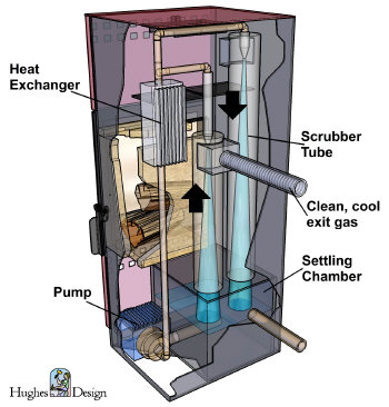

However the price for a wood burner from B&Q is quite low, under £300, but it will not really comply with any regulations, but a condensing stove

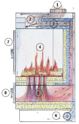

with a plastic horizontal flue pipe, looking at a few £1000 pounds. OK that is not a normal stove but this one
is more a normal stove for every day use, note the water cooled jacket, which in turn needs a method to store and use the stored energy

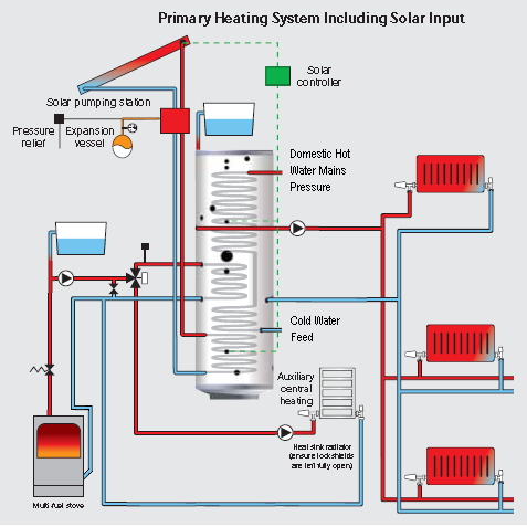

now your looking at £10,000 to install, personally can't see how it would ever pay for its self, my brother-in-law had it in his last house, and yes it worked, a fire in evening was enough to keep house warm all day, plus heat from solar panels, but I just get oil delivered twice a year, the cost to install a proper multi fuel fire is just far too much.
