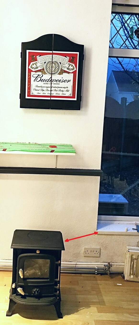

Looks like I will have to forget it - I have just realised there is no way I can position the stove that maintains the minimum required distance of 600mm to the PVC widow frame & ledge on the Right hand side.
Unless there is any way out of this?, if not looks like project abandoned

Pricier ,but some of the small woodwarms are down to 152mm back and sides and will sit on a 12mm projected hearth.
Lateral support above the roof still seems to be the most difficult part
