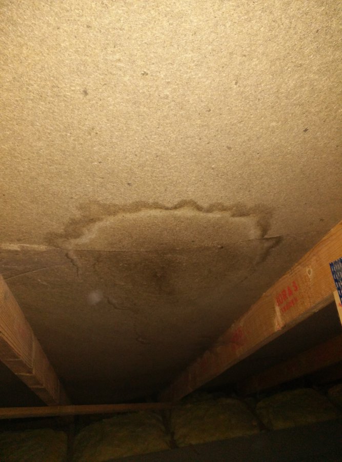

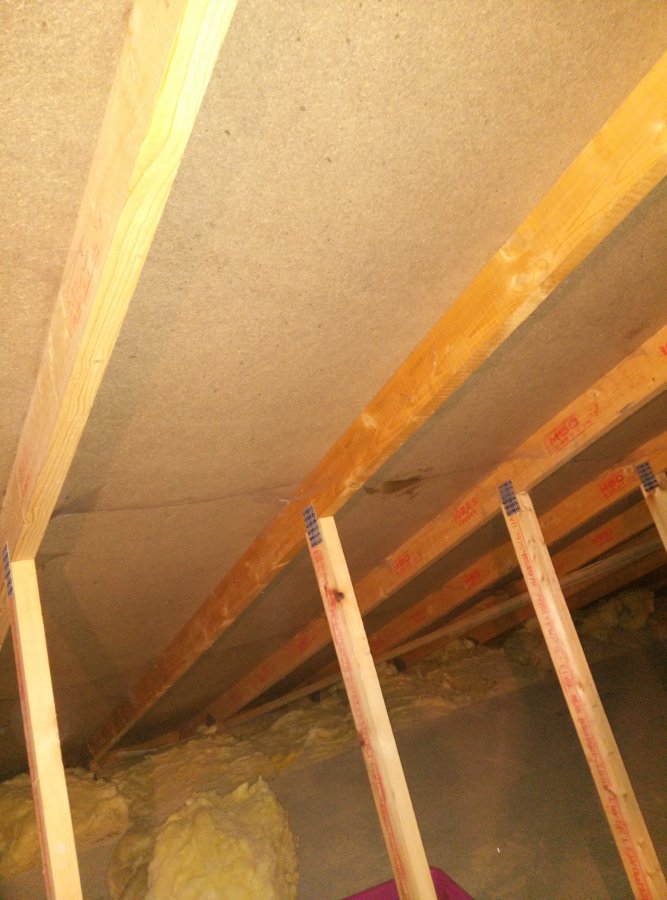

Hi all. Moved into a new house a few months ago which has an interlocking concrete tile roof. The ridge needed repointing when we moved in but this has been done. House is about 30 years old.
We have had some very strong wind in the last few days with some heavy rain and I have noticed a number of Damp or wet spots in the loft on both sides of the roof.

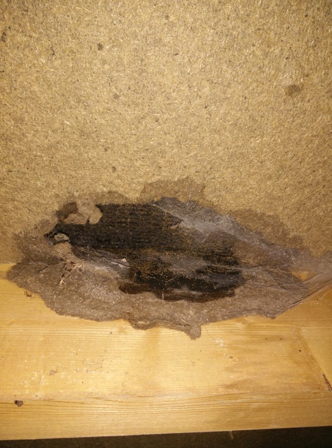

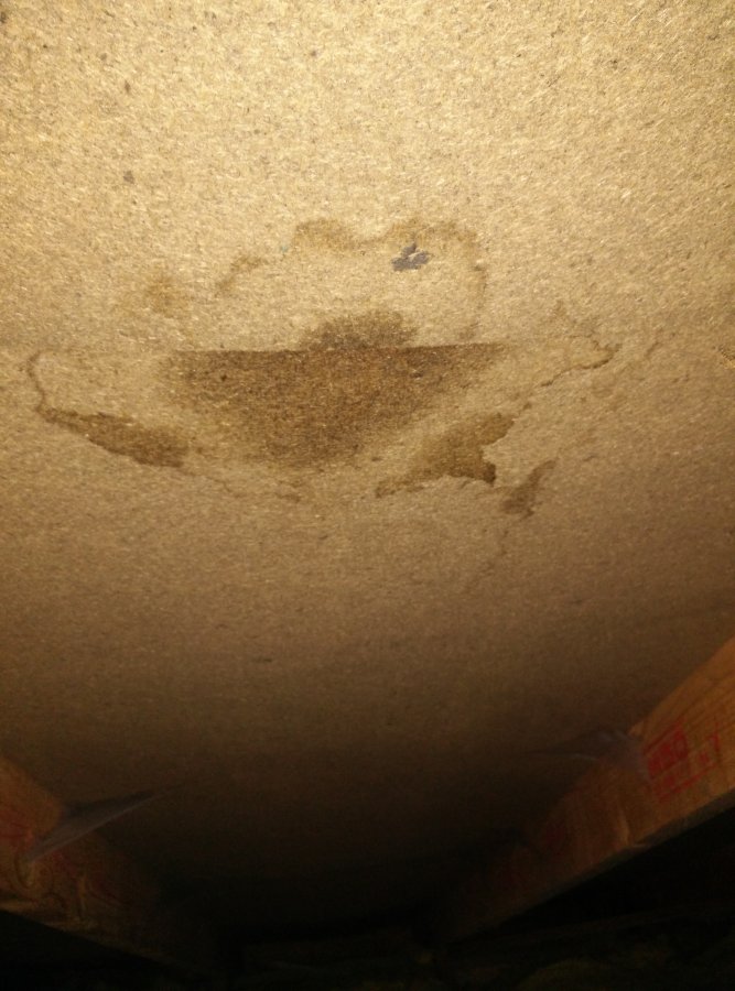

The underside of the roof in the loft seems to made of felt like fibre board and it is these that are wet. They are dripping at some joints.
Looking more closely there are some historic Damp stains but looking from the outside there are no visibly broken tiles.
I have left a message for a number of roofers but as yet no one has called back and I'm unable to get up there myself.
As the issue is quite widespread what could be causing something like this? Any ideas so I'm prepared for the trades would be useful.

Some tile roofs built in Scotland (in the 70's, maybe beyond) were built with half inch fibreboard as boarding, then underslating felt, then battens/tiles etc. Over time the fibreboards move/shrink, or the trusses move slightly, such that the fibreboards slip off the trusses and sag into the roof space. The felt also sags and if one of the sagged areas has a sideways felt lap then you end up with an open path for any water to run straight in. Also if the vertical felt laps aren't very big they open a gap almost anywhere the boards have sagged.
Your tiles should keep most of the water out but in my experience there's always some trickle marks on the underfelt somewhere, where small amounts of water have been running. Some water can be blown up under tiles during storm conditions, especially if the tiles aren't so well interlocked as they were 30 years ago.

I don't see how rain can be blown up and under a tile, enough to travel 75mm or so up the headlap and enough to cause staining but, I do agree that there must be water ingress.
You should have the roof checked for broken/cracked/slipped tiles.
There's obviously enough water to cause staining and through chipboard so I'd expect a broken tile.

Right, now I can see you have under felt(1f).
The leak will be above any patches, between the stain and ridge so start looking in those areas.

Only because Alan above said that's what had to be done on another roof of similar setup. Also interesting that at either end of the roof (gable ends?) the boards look Damp from top to bottom. On inspection from outside it looks as if they protrued out into the open and aren't protected which I cant imagine is right.
